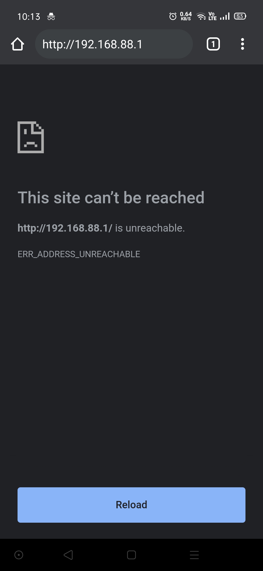

My 11 year old son had made some changes in the IP:192.168.88.1 setting. Now I can’t access the IP.
It shows “site unreachable” how can I access and reset it all.
