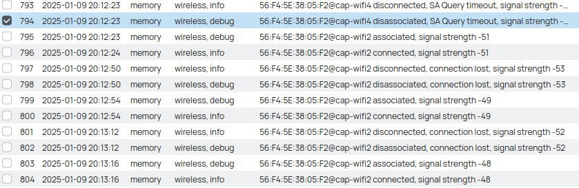

But no device can connect to this AP. The weird thing, when I’m connected to first AP 5GHZ (cap-wifi4) and move to the second one (cap-wifi2), I can see in the logs the connection to the second but after few minutes without connection I loose it. I have the issue with all my devices.
