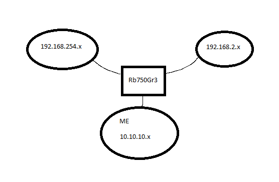

Hello all,
Im pretty new to RouterOS, I have managed to configure successfully some mangle rules and traffic shaping before, simple queues too. Now im dealing with a problem that I dont even know how to google. I have 2 networks in my office: 192.168.254.x and 192.168.2.x, I want to connect 2 ethernet cables to my mikrotik RB750Gr3(one from each network) and make a new network for example: 10.10.10.x which im going to connect to with my PC. I want to be able to be in both networks(connect to web configurations devices in both networks and servers) but I dont want the networks to “see” each other. Both networks have their own gateway, i want to use 192.168.2.1 that is the faster connection. Appreciate the help!
You can accomplish what you want already via firewall rules.
It sounds rather simple.
You have two office networks A, B connected to the router on lets say ports 2,3
You want to be able to reach into both networks at any time
Where are you located ( on office network A, B, a different network?) and which port??
If you need to create another subnet just do it.
Then you use firewall rules to establish what traffic is allowed.
What have I missed in your intentions??
Im not in any existing network, i want to be in port 3 creating a new subnet. Here is the diagram, my knowledge is not high enough to understand it exactly as it is.
Yes that is very easy to do…
So, how do I do this? Can you explain it or give me the links for tutorials on this? Thank you very much
