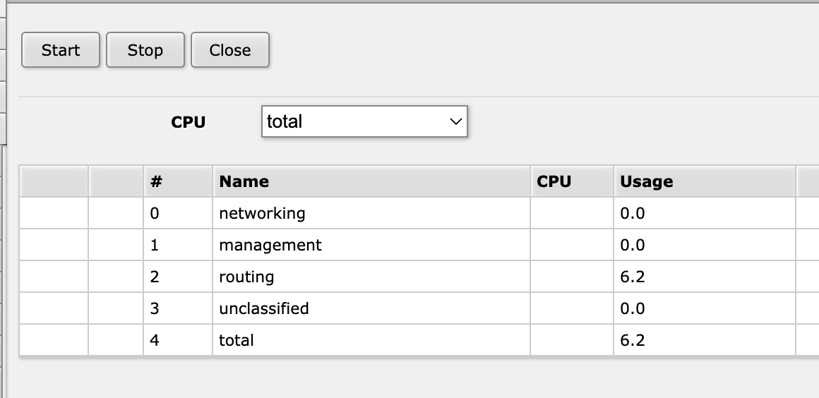

All this time CPU load is around 6-7%.

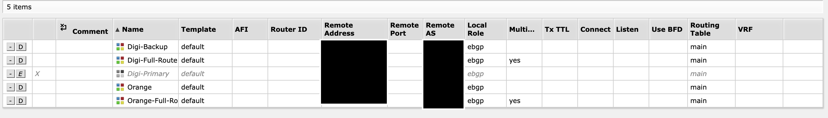

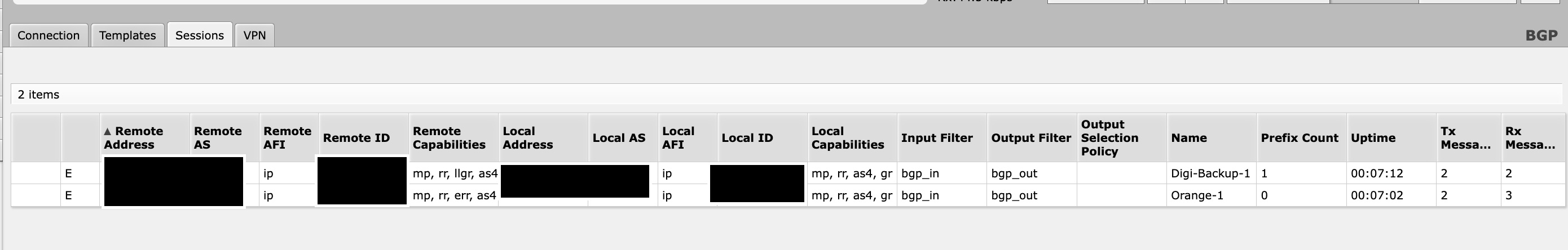

It was just an example, the biggest problem is that although it uses a small amount of processor, once the processing full routing bgp session starts, it blocks the processing of other sessions.
e.g:
In the session table I see only 2 sessions, although all 4 are established (I checked with the providers) :
it practically blocks the normal operation of the router, although the processor and ram memory are used to a minimum.

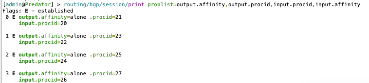

There are certain tasks done by one process, check this article how multicore with routing processes work:
https://help.mikrotik.com/docs/display/ROS/Routing+Protocol+Multi-core+Support

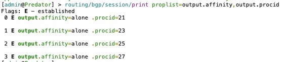

To me it looks like I have multiple process:
Thank you!
As it is described in the article above input and output processes are not handling route calculations.
bgp input process receives updates, decodes and sends routing info to main process.
Main process is doing the calculations
bgp output is similar to input, it “asks” for routes from the main process, encodes and sends the packets.
Got it now!
