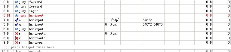

3.14 hotspot problem or bug???
show red line but hotspot not work

what is jump target of that rule? if target chain do not exist, then the rule will be red and will not be used - it’s normal state
