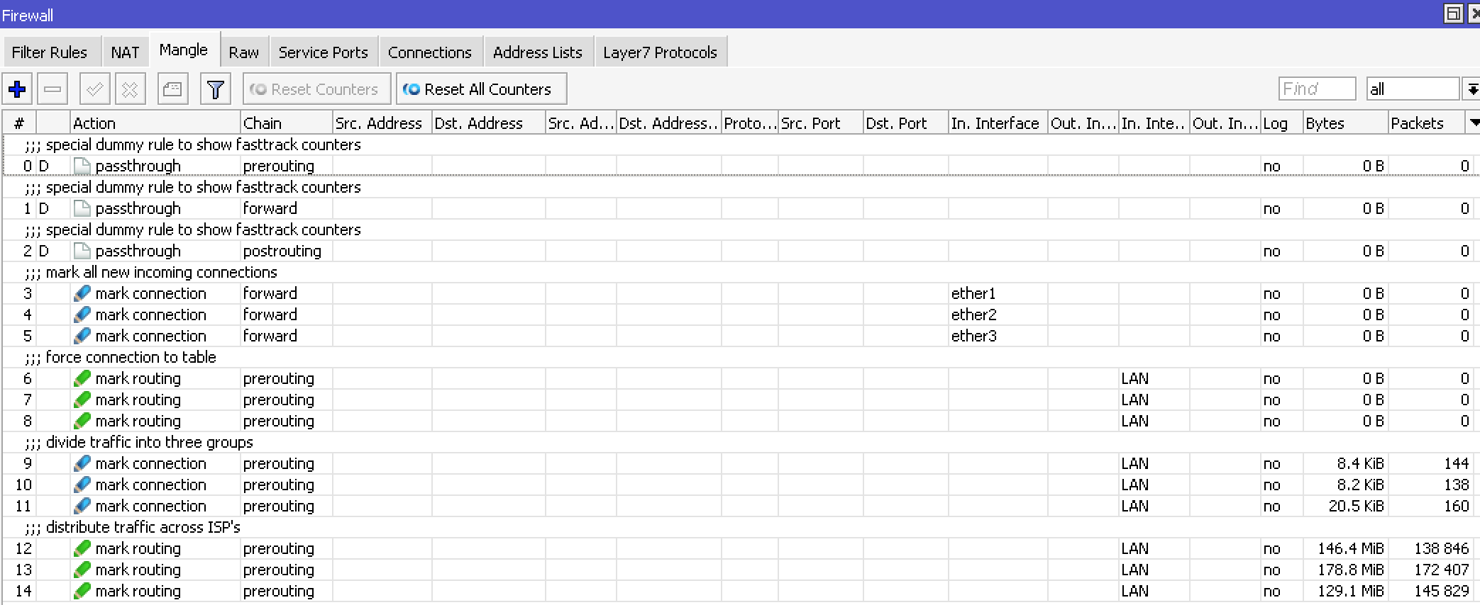

Hello everyone. Need some help on triple ISP config with PCC load balancing. Looking for assistance to please look at the mangle & routing rules. Also the DHCP-client script. Config & concerns are below.
HEX on ROS 7.13.4 using winbox
ISP1: ether1 (100/100)
ISP2: ether2 (100/100)
ISP3: ether3 (100/100)
Lan Bridge: ether 4 & ether5
Concerns:

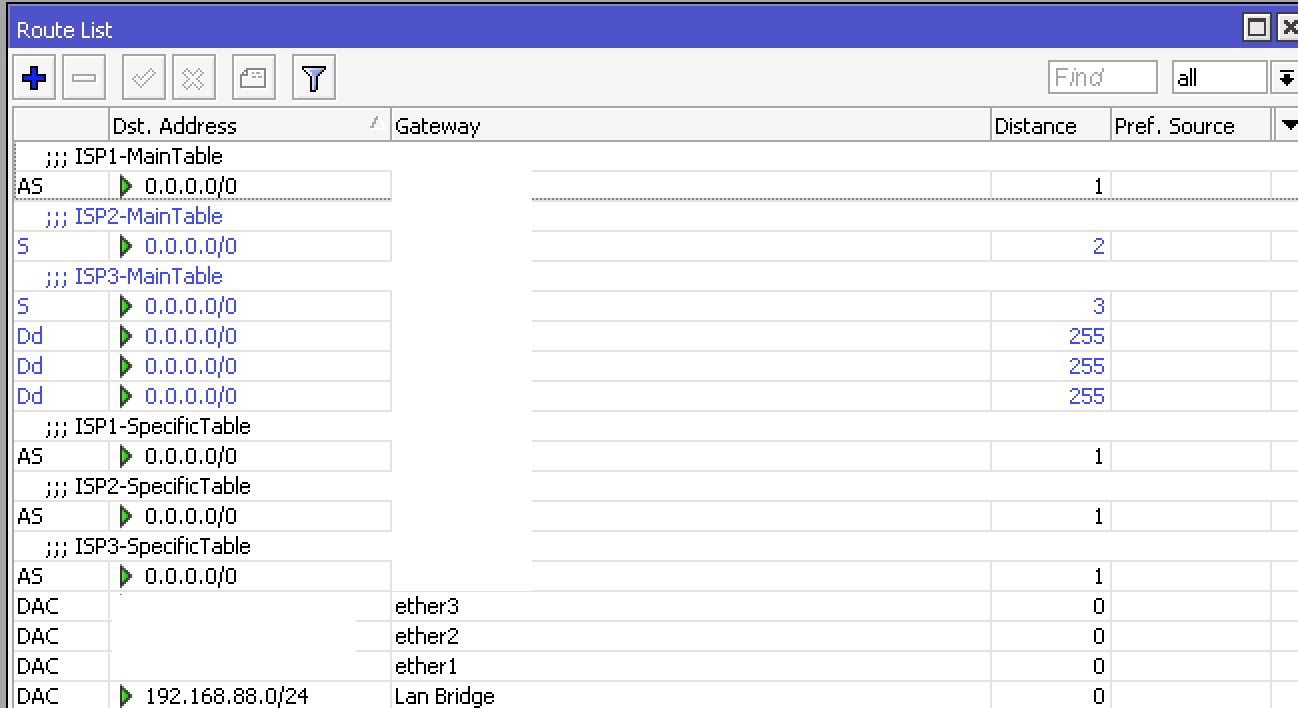

Mangle rules: I’m not sure if the rules are correct, the ordering of the rules, using passthrough properly, etc. For some reason, when WAN-3 is disabled (interface disabled or cable unplugged), the prerouting mangle rules for ether3 (ISP3 / to_ISP3) still have traffic, also shown in connection tracking. I delete the connections but still connections repopulate like it’s connected. The output chain for ether2 & ether3 barely have any traffic. Most is on ether1, a lot of it. Leading to believe load balancing isn’t working as intended because I mucked something up.
dhcp-client: The dhcp-client creates a default route for each ISP (not sure I should be doing this or it’s ok). I also create new routes for routing tables to_ISPs. Found a script to update the gateway & also delete the connections when the gateway IP changes. Problem is, neither work. The GW is not being updated nor are the connections being killed/deleted. I don’t know anything about scripts. I’ve tried copy/paste script in the dhcp-client advanced tab in winbox & also using the terminal.

/ip firewall mangle
add action=accept chain=prerouting comment="Lan Bridge access" dst-address-list=expected-address-from-LAN in-interface-list=LAN
add action=mark-connection chain=prerouting comment="mark all new incoming connections" connection-mark=no-mark connection-state=new in-interface=ether1 new-connection-mark=ISP1_conn passthrough=yes
add action=mark-connection chain=prerouting connection-mark=no-mark connection-state=new in-interface=ether2 new-connection-mark=ISP2_conn passthrough=yes
add action=mark-connection chain=prerouting connection-mark=no-mark connection-state=new in-interface=ether3 new-connection-mark=ISP3_conn passthrough=yes
add action=mark-connection chain=prerouting comment="divide traffic into three groups" connection-mark=no-mark connection-state=new dst-address-type=!local in-interface-list=LAN new-connection-mark=ISP1_conn passthrough=yes per-connection-classifier=src-address-and-port:3/0
add action=mark-connection chain=prerouting connection-mark=no-mark connection-state=new dst-address-type=!local in-interface-list=LAN new-connection-mark=ISP2_conn passthrough=yes per-connection-classifier=src-address-and-port:3/1
add action=mark-connection chain=prerouting connection-mark=no-mark connection-state=new dst-address-type=!local in-interface-list=LAN new-connection-mark=ISP3_conn passthrough=yes per-connection-classifier=src-address-and-port:3/2
add action=mark-routing chain=prerouting comment="distribute traffic across ISP's" connection-mark=ISP1_conn in-interface-list=LAN new-routing-mark=to_ISP1 passthrough=yes
add action=mark-routing chain=prerouting connection-mark=ISP2_conn in-interface-list=LAN new-routing-mark=to_ISP2 passthrough=yes
add action=mark-routing chain=prerouting connection-mark=ISP3_conn in-interface-list=LAN new-routing-mark=to_ISP3 passthrough=yes
add action=mark-routing chain=output comment="force connection to table" connection-mark=ISP1_conn new-routing-mark=to_ISP1 passthrough=no
add action=mark-routing chain=output connection-mark=ISP2_conn new-routing-mark=to_ISP2 passthrough=no
add action=mark-routing chain=output connection-mark=ISP3_conn new-routing-mark=to_ISP3 passthrough=no

add check-gateway=ping gateway=ISP1-IP routing-table=to_ISP1 distance=1 comment="ISP1"
add check-gateway=ping gateway=ISP2-IP routing-table=to_ISP2 distance=1 comment="ISP2"
add check-gateway=ping gateway=ISP3-IP routing-table=to_ISP3 distance=1 comment="ISP3"
