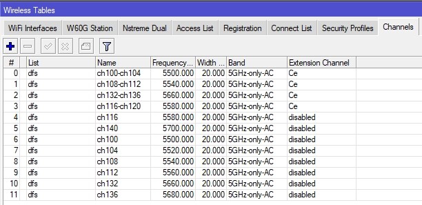

I did a lot of of reading (this really helped - https://shop.duxtel.com.au/article_info.php?articles_id=51) and fine tuning to my setup and have
a fairly stable Connection now, although I only get a Bandwidth of about 4-5 mbps across my Link. I did move around the best DFS Spectrum,
which actually is allowed unlicensed Spectrum in my Country. Cut my MCS Rates to the minimum, adjusted TX Power down, moved my Routers again to the
best possible Position and am stuck on 10Mhz Channel Width with fairly decent Signal and CCQ, the Moment I move to 20Mhz my Link breaks under Load. Although
when use the same Spectrum on 10Mhz in adjacent Channels it is stable. Sadly Frequency Usage or Wireless Snooper does seem to function in that Frequency Range,
but Spectral Scan and History helped, although the Chipset on the SXT SA does not support this and I dragged a Omnitik to my high Site for this. By now I am convinced
that my Receiver in the SXT SA has some damage and is not working properly, will do some more Tests with other Mikrotik Routers I have, to confirm his. On my one Link
there is a huge difference (15db) across multiple Frequencies between the signal in both Chains. Last but not least moving to AC only makes real sense when you utilise
80mhz or 160Mhz Channel width, as there will no gain on 20 and 40Mhz Channel widths.

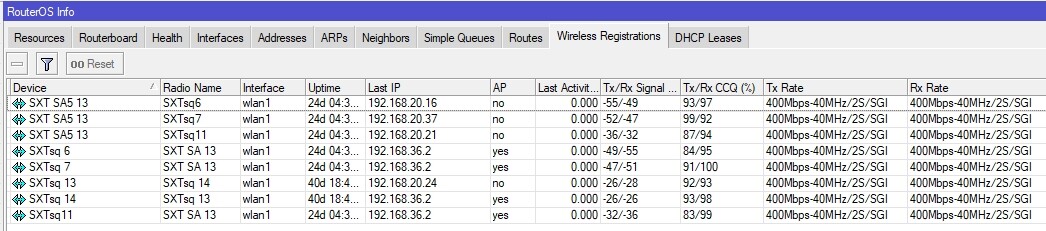

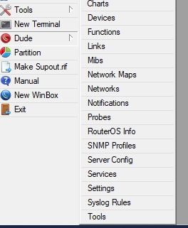

One last Question I have, where did you get the RouterOS Info Window in Winbox ?
Regards
W
I expected that question, because it is non-trivial
It comes from the optional DUDE package. But it is not in the Dude client screen, it is in the RouterOS Winbox menu, in Dude, RouterOS Info
DUDE with its SNMP and RouerOS probes and SYSLOG data collector has proven to be extremely usefull in following up this Mikrotik (and Engenius and Draytek) network over more than a year now. Lots off traffic graphs and full incident reporting (link down and up) for links and AP’s.
This one screen (Router Info) learns me a lot over the instant state of the wifi PtP and PtMP connections.
