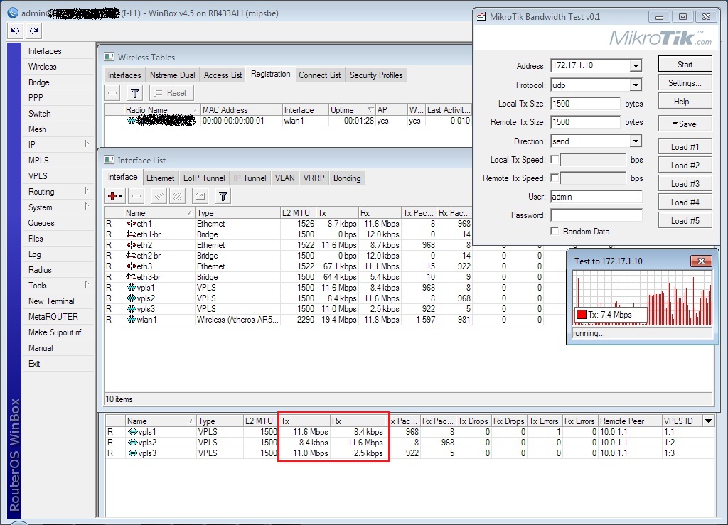

OK, I’ve done it. By adding another vpls just with diferent VPLS ID.

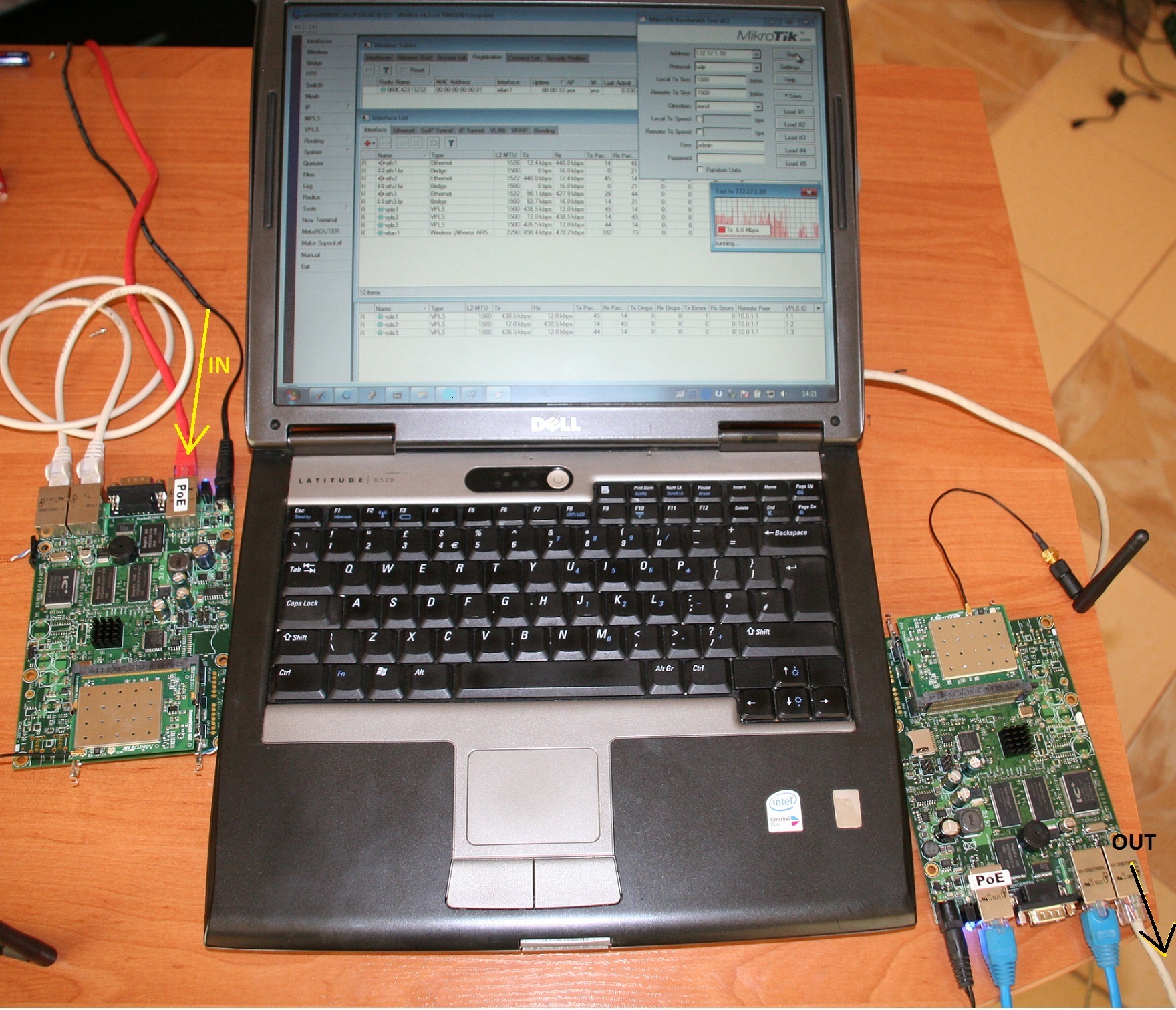

attached testing just for fun :slight_smile:
