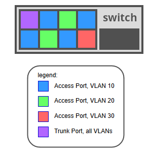

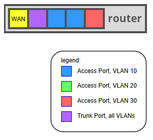

I have a Mikrotik router (RB960PGS hEX) and switch (CSS610-8G-2S+IN) and I would like to configure 3 VLAN’s in the following setup:
Each VLAN is suppose to have their own IP range.
VLAN 10: 192.168.0.X
VLAN 20: 192.168.20.X
VLAN 30: 192.168.30.X
No VLAN’s should be able to contact each other, only access to WAN.
Inside each VLAN, the machines can talk with each other without issues.
VLAN 10 is the only VLAN that should be the only ones able to connect to the Switch and Router for management

Well you the hex is not even close.
You have no vlans defined,
The vlans need their own dhcp setup so remove the one attached to the bridge.
Each vlan needs their own address etc.
Then you need to define the bridge vlan portion of the setup and adjust the bridge ports setup to reflect the access ports and trunk ports accurately
Its like you didnt read the link provided for the hex??

For the SWOS, there seem to be no hybrid ports in your setup so pretty clean so I had a quick look and this appears to be the way!
Should have Assuming port 1 is TRUNK from router, rest are access ports
VLANS -
ID 10 port checkboxes ticked for 1,2,4,5,7
ID 20 port checkboxes ticked for 1,3,6
ID 30 port checkboxes ticked for 1,8
VLAN - Ensure vlan mode is enabled for ports 1-8
Vlan receive: ONLY TAGGED for port 1, ONLY UNTAGGED for ports 2-8
Default VLANID (PVID): Port One=1 Ports Two-Eight respectively–> 10,20,10,10,20,10,30 [2,3,4,5,6,7,8]

What I would do is keep one port on the router let say ether5 attached to 192.168.88.1 AND NOT on the bridge.
That way you always can access the router and make changes to the rest of the bridge and ports etc,!
In other words, enter the router as is on ether2 and then modify first ether5.
Then connect to ether 5, modify everything else for a bridge with ports1-4.
so while hooked up on ether2,
remove eth5 from bridge ports and add another IP address…
add address=192.168.88.1/24 comment=defconf interface=eth5 network=
192.168.0.0
Ensure you add it to the interface list members
add interface=eth5 list=LAN
Just to be sure not sure if needed add
add address=192.168.88.0/24 dns-server=192.168.88.1 gateway=192.168.88.1
Then add the vlans and associated structures
Then make changes to the bridge ports as necessary for trunk and access ports.
THen add the bridge vlan settings.
Then go back and enable FILTERING on the bridge (last step).
Often this last step kicks the router off line and you have to relog in.
Do so and you can confirm if bridge vlan filtering is then enabled.
Configure the switch and connect to ether2 on the hex and it should work.
