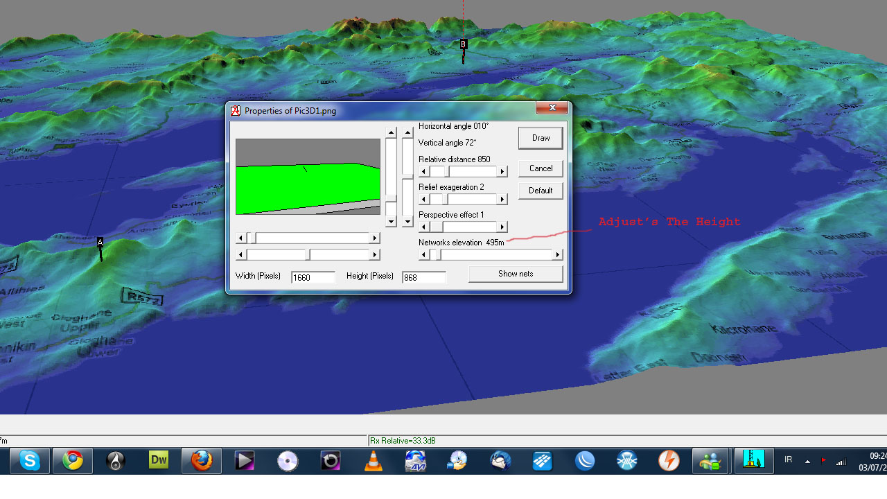

WHOA! How did you get that 3d persepective view in RadioMobile? I use that every day and have never seen that! NICE!
I can see now from 3d graph - 10/20 Kms test cannot be done unless you use a boat or go straight across the bay,

Hi Just click on Picture properties (14th icon from the left ) then 3D on the right .Like all things in RM took me a while to figure it out.

My network names keep ending up in the sky on the 3d picture. How do i make that work like yours, where the link line is actually where the signal is going, not a mile above the land?
Do you mind posting the settings you used in the 3d picture window so I can try to duplicate your nice one, mine keeps looking funny/
Thank you!
Try this to see if it helps.

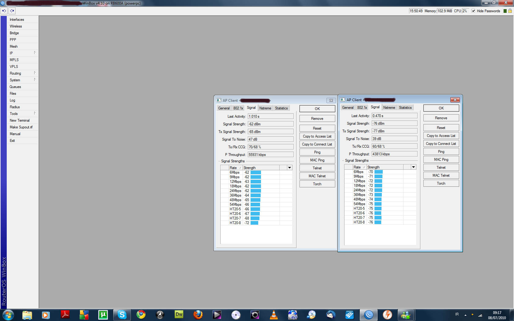

Looking at your 3d map, not sure if this revelant but i noticed the rx sensitivity 0.75uv / -109.5dbm ?
thought radio cards went down to -95 +/- , and not -109.5, also the tx power of r5h @54 is 20dbm, sensitivity -82dbm @54,i would also allow 2db cable/line loss,
Hello, I have a similar setup, 40 chilometers, but with XR5 in turbo mode frequency.
With the H-POL I have 40 Mbit of TCP (one-way) troughtput.
With the V-POL I have 30 Mbit of TCP (one-way) troughtput.
The antenna is the same, but I have 4 XR5 running in 4 RB411AH and balanced with OSPF.
100% ccq over the H-POL and 90-95% over the V-POL.

With the R52HN cards throughput up but ccq is down, I believe to date MK 802.11n has/had issues ?
http://forum.mikrotik.com/t/802-11n/28753/1
Not sure if this still is a issue but either way i would stick with a setup known to work like 802.11a turbo, nstreame, adaptive noise immunity, reduce data rates to improve ccq, until n is sorted out, I try to install a tested working equipment configured and ready for install on a hill,
At a guess was the client -76dbm the 5180, and -62 the 5700, if yes antenna gain
A possible option is to have one polarity using r52hn cards and the other polarity XR5 cards, and it follows one polarity N std and the other A-turbo, ??

(At a guess was the client -76dbm the 5180, and -62 the 5700)
Yes
Thanks for the advice etc i appreciate it.
Yes
Ok - you have a swing of 14dbm on the link using those frequencies which illustrates to me the importance of having full spectrum antenna’s, it will be interesting how both frequencies will handle the fade margins and which would drop first during bad weather,(snow,Ice),
