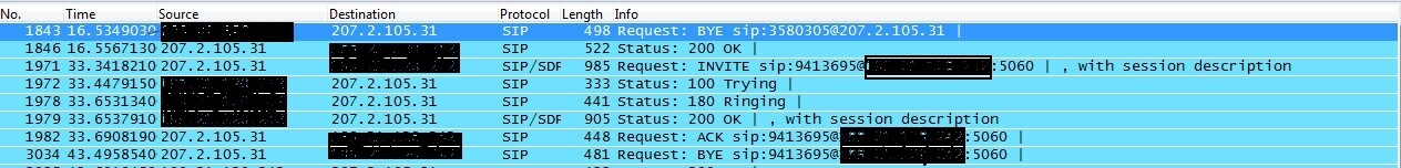

When I replace the linksys with the Mikrotik, I can make calls internal/external and connect using our SIP Clients on our Android phones either through the normal connection or through the 3CX tunnel connection and they work fine.
When I call from an external source to our internal, the call fails immediately upon attempting to connect to the 3CX server. I placed wireshark on the linksys router and the Mikrotik router to compare settings. I found that the Mikrotik fails with error “407 Proxy Authentication Required” I am not sure why this is being generated as the Linksys doesn’t have this issue. I have attached the screenshots of the wireshark. Any help is greatly appreciated, thanks in advance.
Mikrotik Screenshot:
Linksys Screenshot:
Thanks,
BCISupport
Have you turned off the SIP alg? (ip → firewall → service ports). You should.
Hi carl0s,
Thanks, that did the trick. Can’t believe I overlooked this simple checkbox. It is working now, tested with it off and worked, put back on and it failed, so SIP alg is the culprit.
