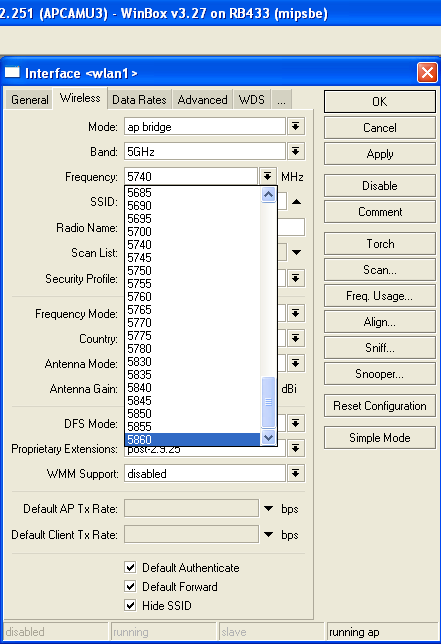

The wiki article is not made by MikroTik, but by some user. You have to check the latest RouterOS v3.27 to see the frequency list.
see attached screenshot
