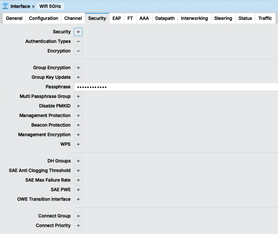

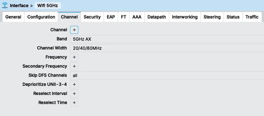

I'm using mikrotik ax2 router but basically I have issue on wifi.
My laptop is connecting and disconnecting from wifi,
Basically I have below configuration:
Basically to solve that (for example iphone is connecting to wifi and after 3 seconds disconnecting) I was thinking about restrict Frequency on it.
Think you missed setting authentication-type (wpa2-psk and/or wpa3-psk).
Setup security on the device (WPA2 psk or WPA3 psk), see if that fixes it.
Is this not applicable on ax devices anymore
WPA2-PSK / WPA3-PSK mixed mode (active by default when explicit types are left blank).
Possibly worth taking a look in the interworking tab and make sure no Realms Raw entry exists.
(remove it if it does)
Ensure laptop wifi card is compatible with 20.40.80 AX ???
