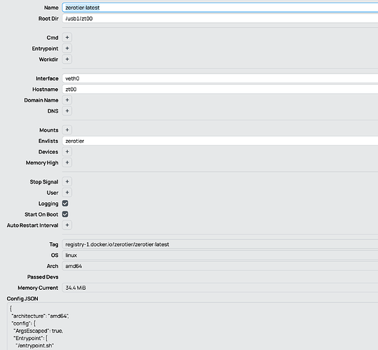

I am using zerotier container for x86 firmware @ 7.20.2
it works fine
I did not upgrade to 7.20.4 because I found problems in the new firmware as reported in this forum
Please note if some of your container do not work, there may be due to the fact the container acquires the network device name as veth?. your container may default to use eth0, etc
this is how I check out recently when move to 7.20.x firmware

I run two instances of zerotier containers in my x86 router. They work.

I just follow standard veth and bridge configuration for container
A separate bridge for vethx interfaces with subnet of 172.18.0.0/24
For firewall, I just port forward 9993 to the zerotier container interface.
Within the zerotier container terminal, zerotier-cli listpeer can list the peers and use as usual
