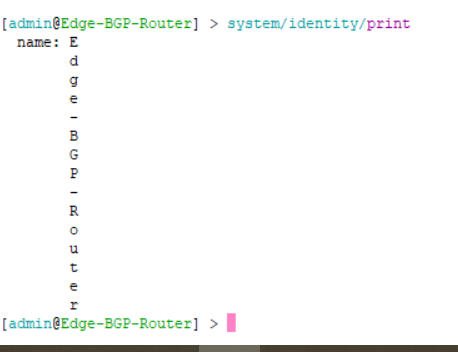

Noticed my ansible stopped working on the upgrade. Did some digging and its dying at the initial login where it checks the identity. Found in SSH (from my machine and internally doing a /system ssh 127.0.0.1), doing a /system identity print
[admin@MyRouter] > /system identity print
y
R
o
u
t
e
r
Where I would have expected
I have only tested on my rb5009s, but I see this on all 14 I've upgraded.
This also happens on my RB5009 and on both of my wAP ax. How on earth did MikroTik manage to screw this up?
Edit: this bug was introduced in 7.23.6.

Upgraded my ac2 from previous long-term 7.23.5 and wifi suddendly comes back, so far so good. I also see the same system/identity/print result with each character per line but it's not a concern for me.

It is the same on hAP ax S which I upgraded to a "long-therm" 7.23.6:
        A
        P
        a
        x
        S
Good thing is that export does not screw it up too :slight_smile:
 system/identity/export
/system identity
set name=hAPaxS
And of course on 7.23.7 it is the same, so yeah now we know.
So how on earth does fixing LTE firmware, mess up /system/identity/print.... So much for accurate changelogs & basic QA.
It must be system stability improvement introduced back in the old long-therm 7.23.6 which also screwed LTE modems :slight_smile:
Same on 7.24.4 as well. Looks "artistic" but serves no useful purpose

Interesting - I had the problem with MIPS device but Dude connected to ARM and ARM64 devices without problem. Maybe it really is related to this identity "format" problem after all. Let's see if this will be corrected in 7.23.10 or 7.24.8 :slight_smile:
I doubt the "format" issue is specific to system/identity value print, it is more likely some library function that is broken and that can be used in other places as well, pretty scary if you imagine that it can also be used to generate kernel netfilter rules for example :clown_face:, hopefully it is not the case but for now I will certainly not install this on anything...
7.23.6
sys/id/print
        A
        P
sys/id/print
        A
        P
