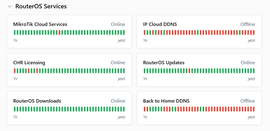

BTH has an massive outage at the moment:
Thanks! Maybe this is the cause, as it seems that DDNS is down too. Fingers crossed!
