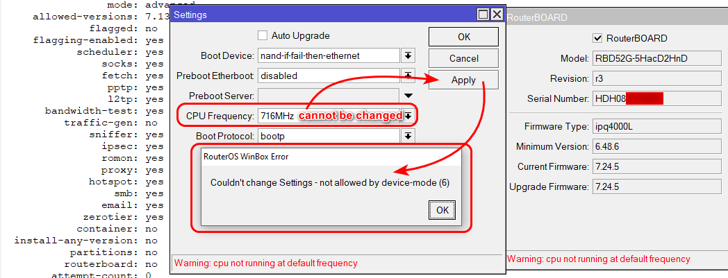

6 - RBD52G-5HacD2HnD , 03.10.2026_21:50_GTM+3 --->
2026-10-03_214515
I'll replace it, but just for the sake of the statistics!
