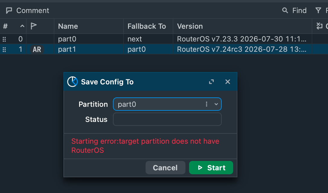

Ah, great! I was looking for an example of that, but did not find it (I thought neighbor discovery settings had it, but it offers no plain interfaces). Indeed that screen has exactly what it should be in the ipv6 nd settings, and probably in almost every place where you can select an interface.
You don't need to look that deep, even the bridge port selection, or the VLAN tagged/untagged lists have since long had such dropdown lists.
Ah yes, I was sure I had seen it but when looking for it I could not find such a place. Indeed there it is available as well.
I would hope that RouterOS could be even smaller when such things are standardized to behave the same in all places and can use a single function shared everywhere, instead of custom code for each place.
