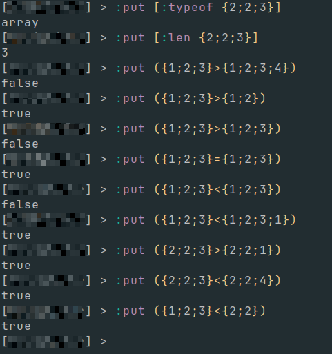

- console - added comparison operators for array type (additional fixes);

- console - added "in" and "has" operators for array types;
