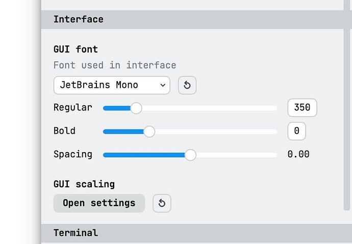

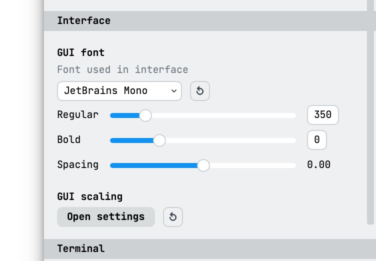

RIP Winbox V3...... I've been holding out moving to v4 because I hated it (and still do) but 7.25 has just forced me to upgrade to Winbox v4..... I guess I'll have to get with the times. But otherwise my home router is now on 7.25 and no issues yet.
set this in the settings and you might start to like it :slight_smile:
:-1:
Too bad, I like Winbox v3 better...
I also liked Windows XP yet i had to move on :slight_smile:
