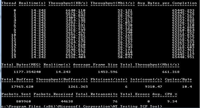

Two 802.11ac routers with Broadcom chipsets. Indoor test:
80Mhz channel
Radio speed connection 1170Mb
Result: 661Mbps real TCP transmission!!!
I can’t wait for new chipsets from Qualcomm :slight_smile:
1 stream/session or more?
Test was made with NTttcp software with 20 session.

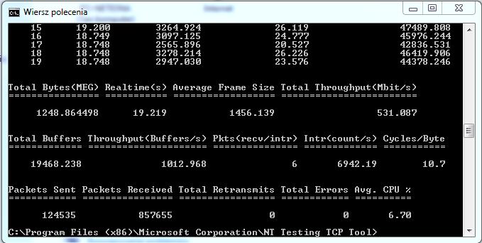

can u post the screen capture?
Here it is:
Old firmware
New firmware

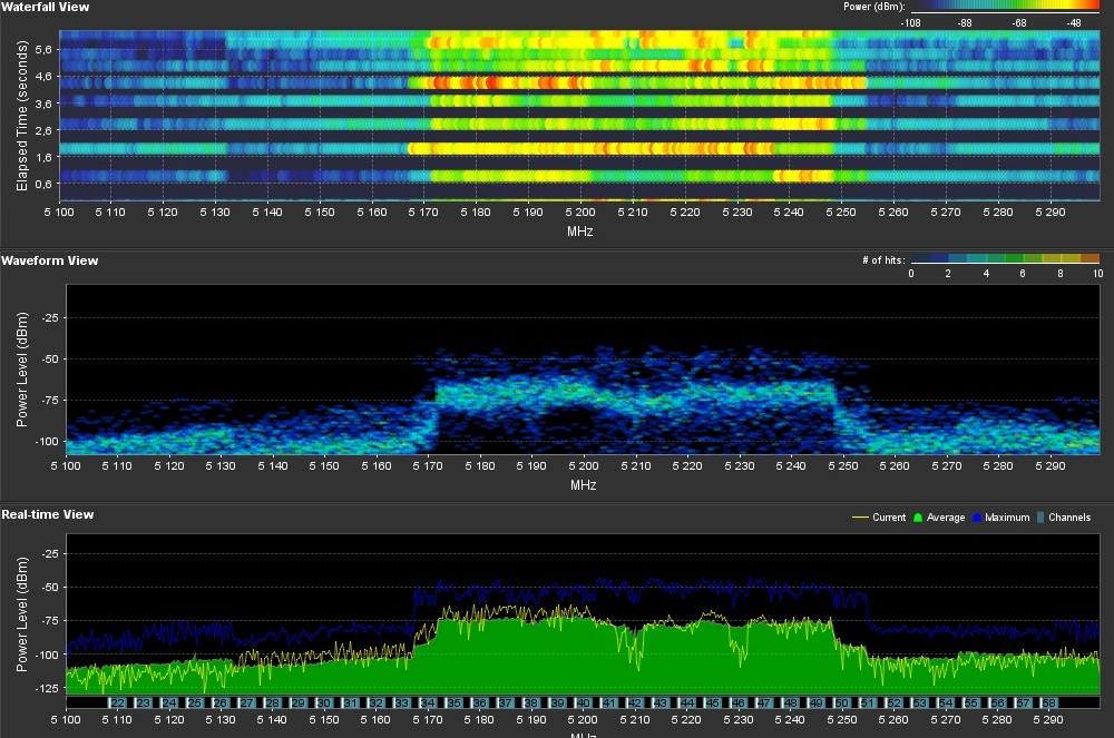

Spectrum:

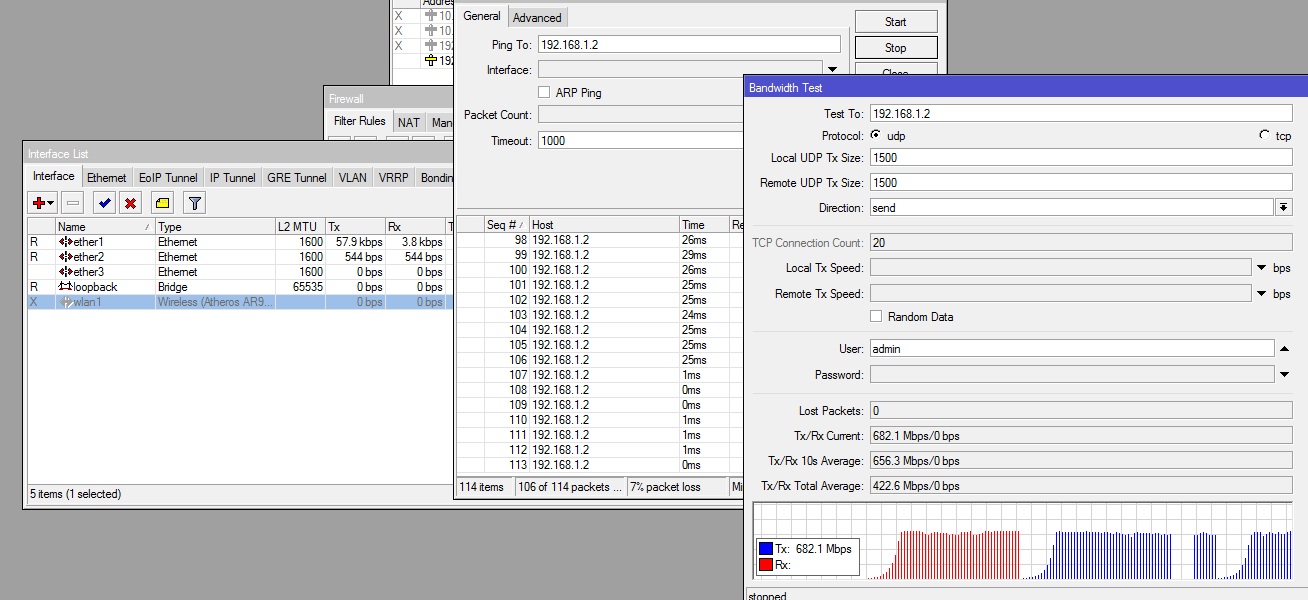

Here is a result od UDP test. Test performed between two RB800. 802.11ac card were connected to two antennas http://www.cyberbajt.com/en/shop_item/3324/pan_519mimo_3x3.html. Distance between antenas about 10m.
WOOW
I managed to get more than 850Mb with UDP test
