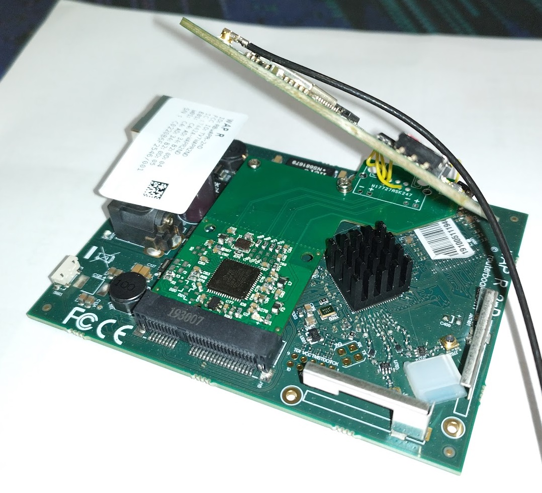

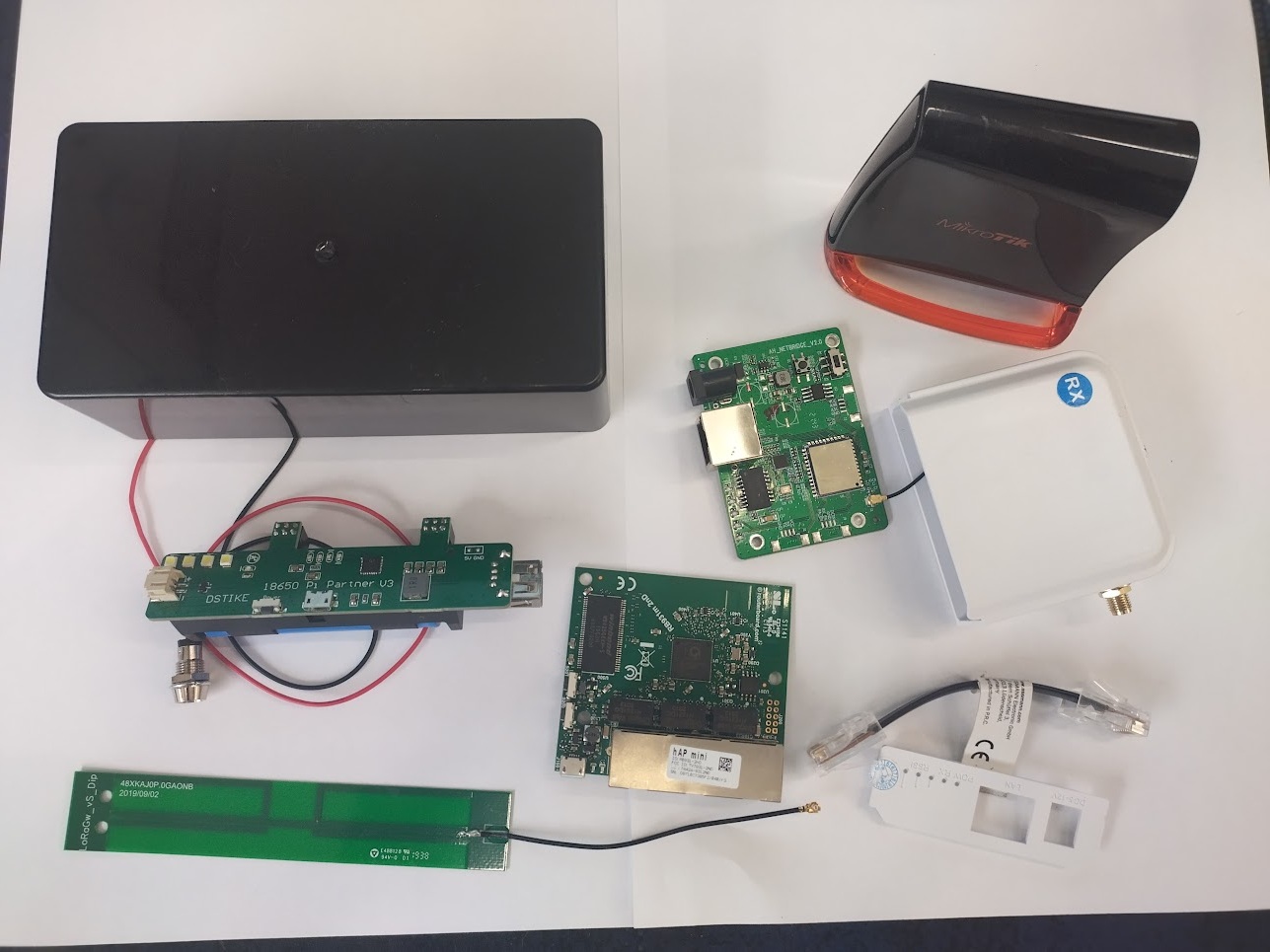

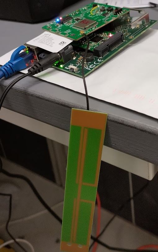

Just follow this easy steps :slight_smile:
  • Have Mikrotik wAP LR8 kit
  • Remove the Lora Card
  • Buy chinese wifi HaLow set for $100 (1Rx and 2TX in my case)
  • Design a mini PCIe board that has LAN9514 USB to Network hub
  • remove the hallow board from its enclosure and remove the RJ45 connector
  • bypass the 5V to 3.3V powe supply on the hallow board
  • use wires to solder the 4 LAN wires and 2 power lines
  • put everything back in Wap enclosure
Now you have mikrotik HaLow + 2.4G Access point

Brilliant! I was wondering how I could get these HaLow bridges glued to a Mikrotik and that’s a bit cleaner than I was considering! I haven’t tried interfacing with the onboard serial (for sending the config AT commands) yet but I’d expect a TTL serial to USB adapter would allow for remote changes.

Mikrotik has very limited support for USB network cards, especially on MIPSBE devices with limited memory.
But LAN9514 acts as network cars and just appears as additional interlace in win Box.
I have almost forgot a step. /s
Remember to save the pcb antenna from lora wap enclosure to create a battery powered HaLow-to-WiFi gateway/access point
Use big enough enclosure to fit all the components and add a red LED to know when it is powered.
