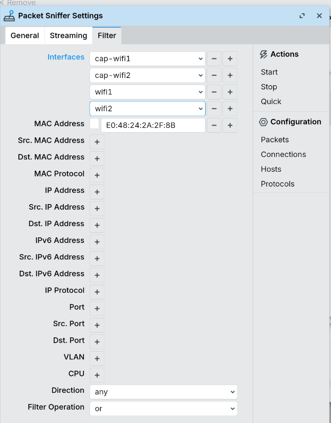

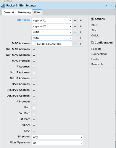

This was the applied filter setting
Now id be interested in the dump.
As my previous poster also said: it might include some data about your network. But quite limited as we filtered the Garmin Mac.
