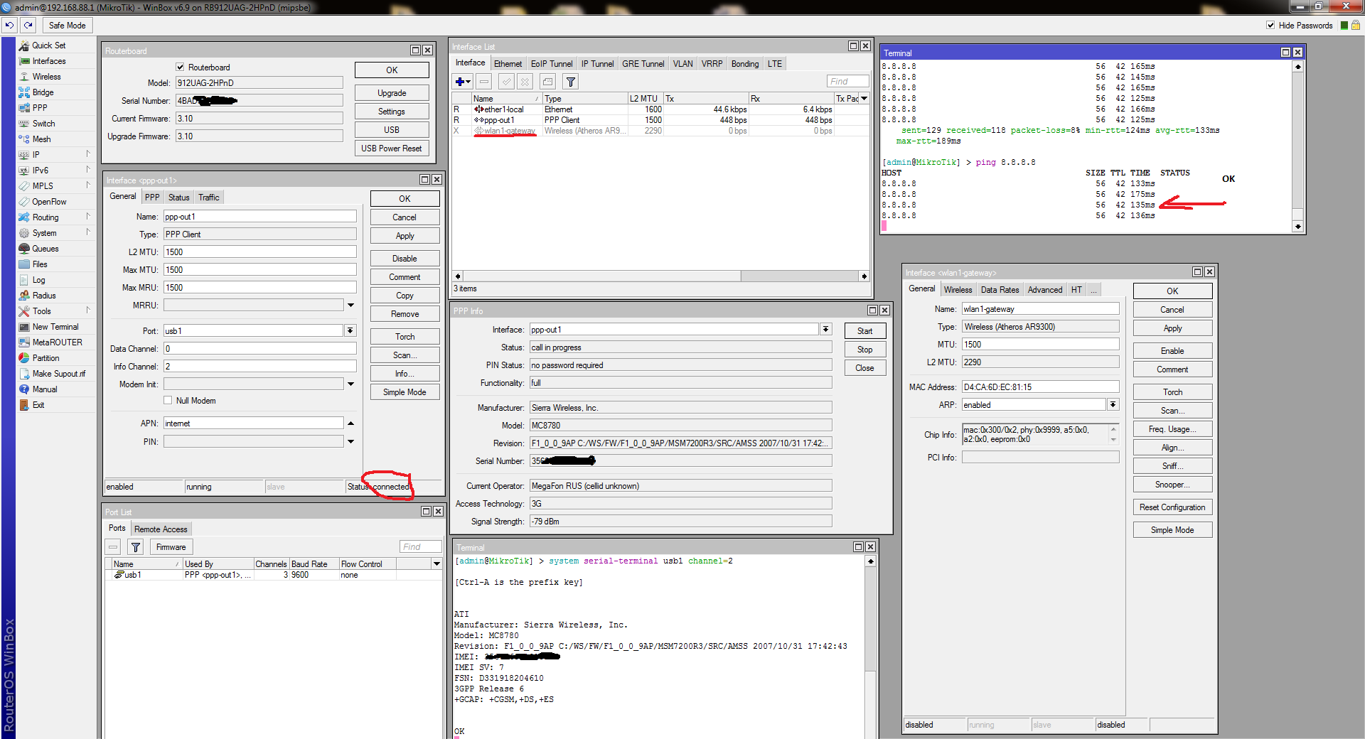

912UAG-2HPnD dont work MiniPCI + Wifi
My configuration
RB: 912UAG-2HPnD
RF StationBox Mikro
Firmware: 3.10
ROS: 6.9
MiniPCIe Sierra Wireless MC8780
data chanel 0
info chanel 2
ROS default configuration

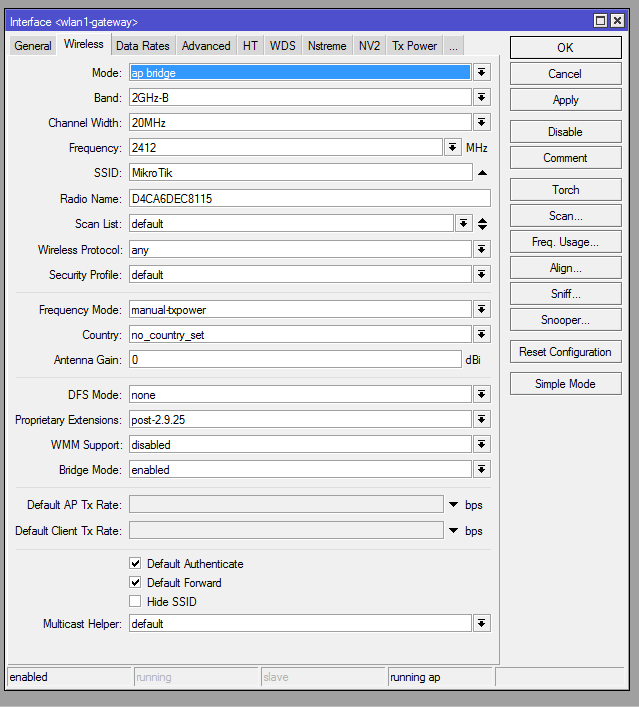

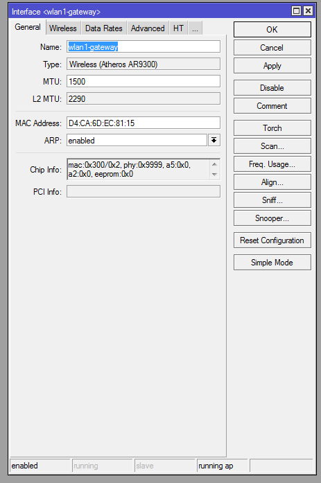

When enable wireless (wlan1-gateway), RB lose connection with MiniPCi module, PPP info is inaccessible and i can’t connect whith terminal command “system serial-terminal usb1 channel=2”. Reboot and usb power reset doesn’t help. MiniPci work only when wlan is disabled.
I have two RB 912UAG-2HPnD and two MiniPCIe Sierra Wireless MC8780. In both cases same result.
It was tested on ROS 5.22, 5.26, 6.5, 6.7, 6.9. with power unit 18V and power injector 16V.
WLAN connected to RF StationBox Mikro whith two MMCX pigtails.
TX power is 17 Dbi.
