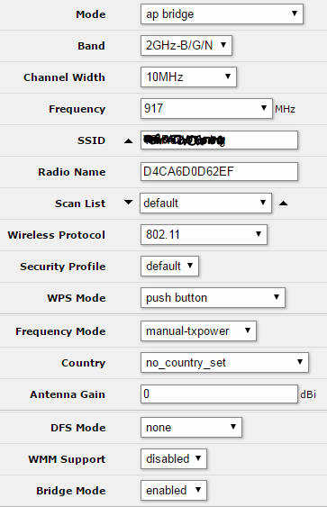

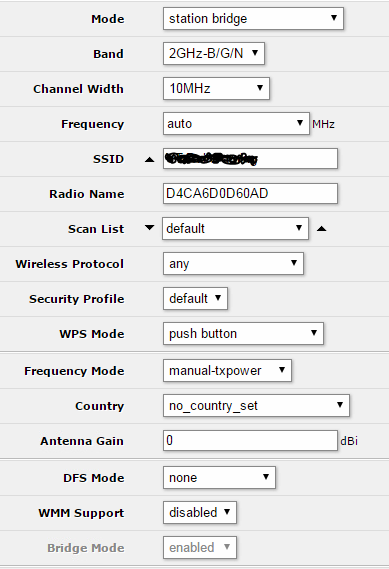

I’ve attached the wireless configurations of the radios
