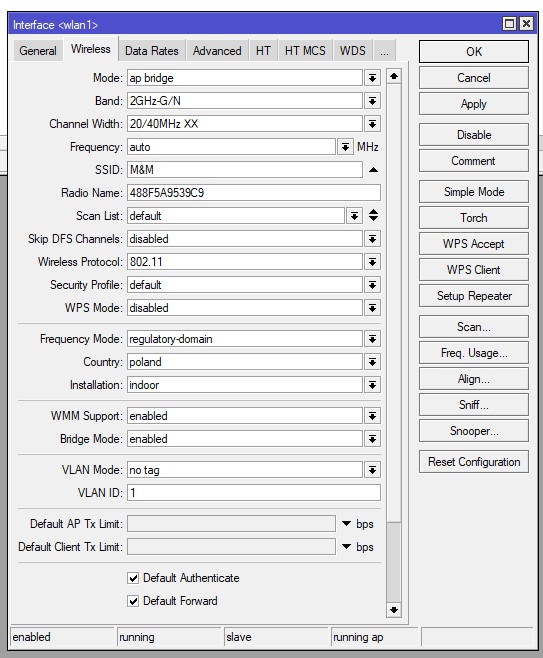

Few months ago, I bought a hAP ac^3 Mikrotik router. Overall everything is fine but I have an annoying problem with WiFi connection.
Whenever I listen to music via Spotify or even locally from Synology NAS - the sound is interrupted every few/several seconds - Short millisecond pauses.
I changed the router to a different one and everything was fine without any interrupts. But I want to stay with Mikrotik :wink:
I use Huawei Matebook (Realtek 8822CE Wireless LAN 802.11ac PCI-E NIC Card), Distance to the router is about 5m. Connection set up at 300mbps, ping about 1-2ms.
I attach MT configuration. Please help :slight_smile:
What causes the interrupts? Probably other signal interfering.
Take control of your setup: check your environment (Freq Usage, Snooper) and avoid other traffic. Activate WMM priority based on DSCP for multimedia.
  • Frequency = auto : you have no idea what you will get! Other brand may select other frequencies
  • Channel Width = 20/40MHz-XX : no very wise to use 40 MHz wide channels in 2.4 GHz band, you interfere with 60% of all frequencies. You have no control on Ce or eC with XX.
  • Music interrupted for other traffic. The priority for WMM does not work in Mikrotik, unless you set a priority rule in the firewall. Everything is priority=0 (just BE, best effort) if not set with a mangle rule
/ip firewall mangle
add action=set-priority chain=forward \
new-priority=from-dscp-high-3-bits
(WMM will give acces to air-time (right to transmit) sooner for higher priority streams in a competing wifi environment)
(remember AMPDU is only set for priority=0 in HT by default. Without AMPDU you will have a large overhead and slower throughput. You might need to set AMPDU for the other priorities)
