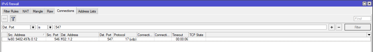

I can even see the connection in the Connections table:
It doesn’t have a state though, maybe that is the issue? If yes, then how can I match it with a rule?
The main thing, I would say, is that DHCPv6 starts by sending a “Solicit” packet to a multicast address (ff02::1:2) and the connection tracking module can’t be quite sure that the “Advertise” or “Reply” packet that comes back (depending on availability of Rapid Commit) can be classified as “related”. But there are even more nuances to this, of course.

That’s because the protocol use multicast. The ff02::1:2 address that you see in your screenshot is a multicast address.

When the server responds, it will of course not be able to use ff02::1:2 as source address for its packets, but a fe80::/10 address, which means the packets will not be tracked as part of the previous outgoing connection.
