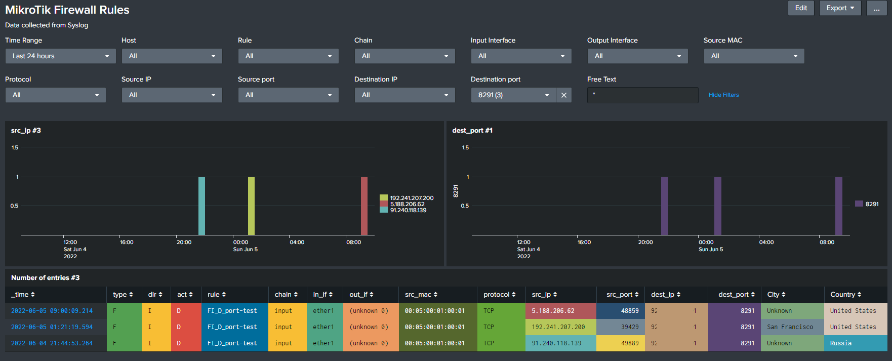

3 different IP has tried to access one of my routers the last 24 hour, and this is an a calm day. And all 3 where added to the 24 hour block list, since they tried one port that was not open. (So there may be more tester out there since they are blocked on first non open port they try).
