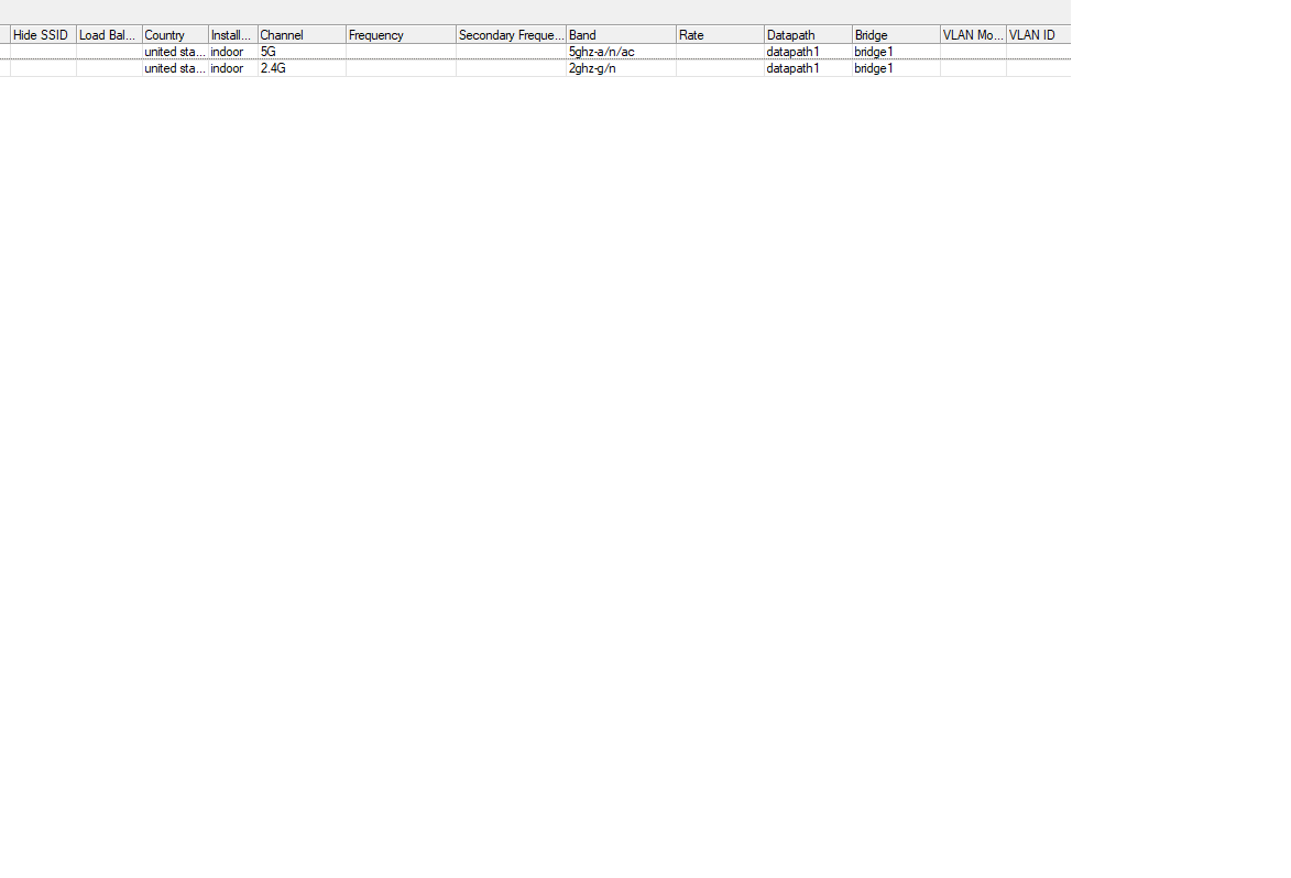

  1. Can you please inform me of the proper way to check this?
  2. My country is not listed, so I selected the United States. Is that okay, or should I select no_country_set?

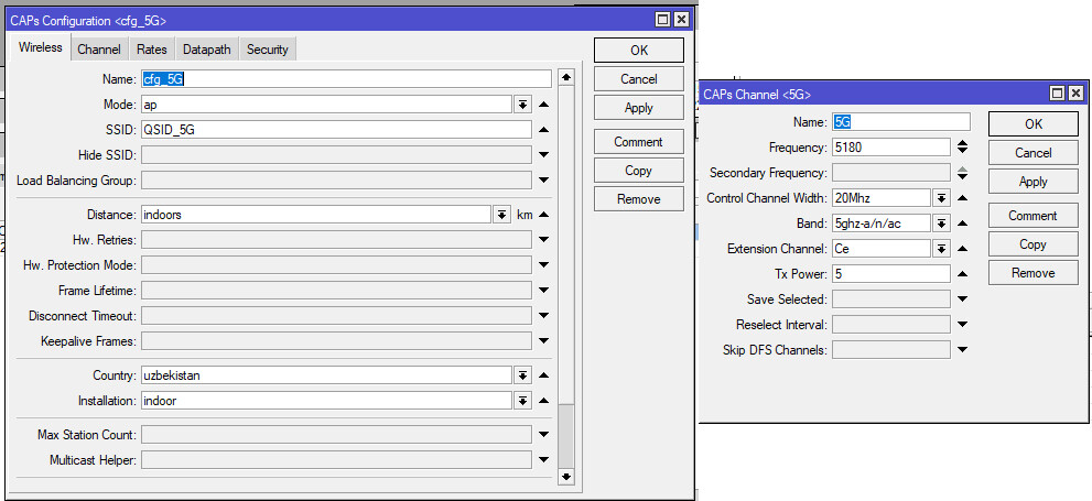

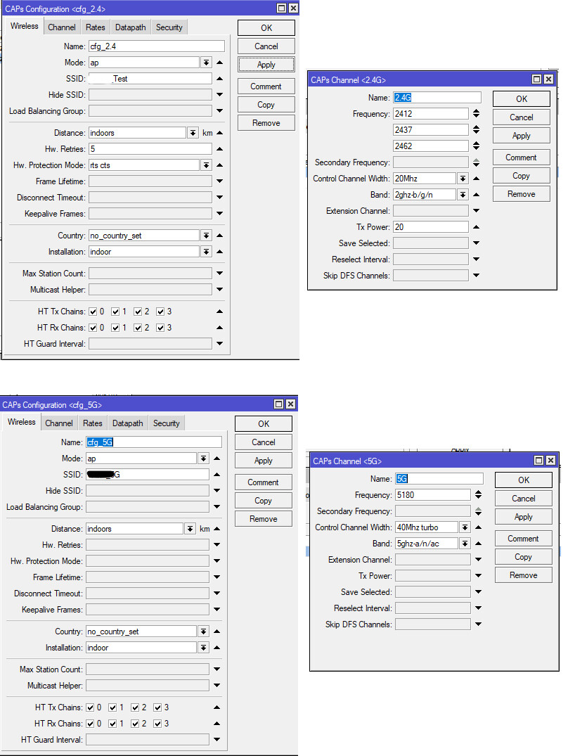

  3. I tried to set up as you instructed (about 5G I’m still wrote only 5180) ( Please review and let me know if any changes are needed. (I’m using CAPsMAN on MikroTik).

When configuring channel widths, don’t use “40MHz turbo”, it’s a not-so-widely-supported wireless layout. To be as compatible with clients as it gets, always use 20MHz as “control channel width” setting. If you want to provide wider channels (in reality they are multiple of control channel width), set “extension channel” property to e.g. Ce (or XX) for 40MHz or Ceee (or XXXX) for 80MHz. The difference between different extension channel layouts is placement of control channel inside the “channel bundle” … it seems that the most widely supported layout is the one with Control Channel at lower edge (i.e. Ce or Ceee). Setting it to XX (or XXXX) means that it’s up to CAP to decide the layout (in principle it’s fine as well, but it may select something other than Ce(ee) and as mentioned, some clients might not like it).
In modern (wifi) capsman, channel settings are organized a tad differently. The new wifi doesn’t support anything but standard 20MHz channel widths, so the channel layout is overloaded into “width” property (you can select e.g. “20mhz” or “20/40mhz” of “20/40mhz-Ce”). Which actually makes it more clear that “wide” channels are composed of multiple 20MHz channels.
Checking external interference: while ROS provides a few tools, it’s quite handy to use smart phone with a scanning app installed (I use “Wifi Analyzer” but there are others). Use it close to your AP (but turn off AP while doing the interference scan to avoid AP to overload phone’s receiver which would then show much less interferers).
I guess proper thing would be to set country to something. united_states might not be entirely correct for your country, specially in 5GHz band different countries impose different restrictions and it is possible that regulatory agency may chase you down for not adhering to regulations (e.g. using too high Tx power … not very likely if you’ll be using your AP indoors … or using frequencies not allowed in your country or not adhering to DFS rules which vary from country to country as well).

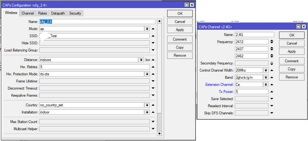

I used for 2.4 and 5GHz bands 20MHz as a “control channel width” in the setting.
Really, I don’t think I need wide channels because there are access points in every classroom and also in the halls. (But I did as you wrote, please look again, and let me know if something still needs to change).

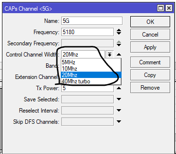

Regarding the country, I couldn’t find mine on the list, so I chose a neighboring country. Is that okay?
It seems like my device doesn’t have just 40MHz; there is only with a turbo. (I have the last firmware update 7.13.3).

That’s fine. And the Extension Channel setting makes both 2.4GHz and 5GHz radio to work with 20 and 40MHz wide channels. I suggest you not to do it on 2.4GHz radio.
Most probably it’s fine (specially so if your country shared common history with Uzbekistan before 1990 which would make higher probability for similar country regulatiobs regarding radio frequencies).
