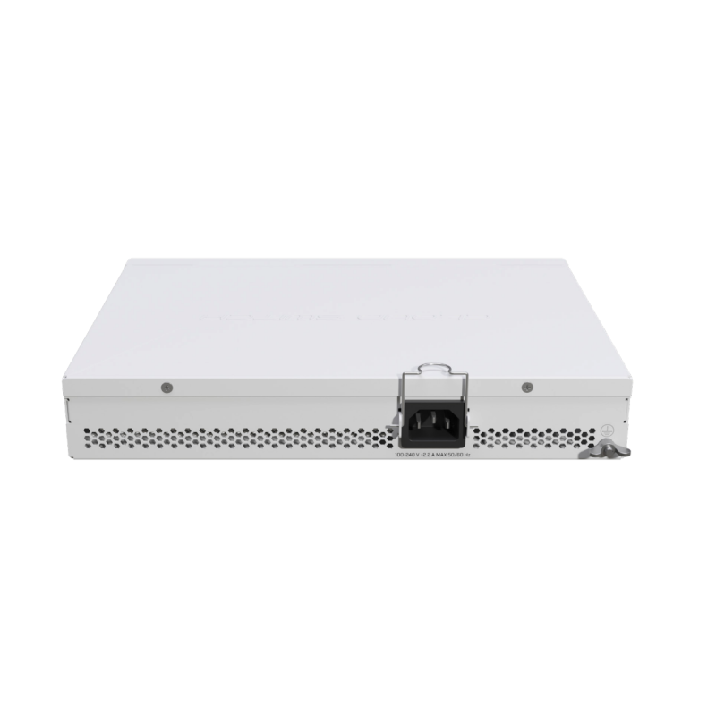

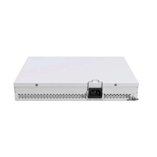

@memelchenkov - As I wrote, I did two “changes” at once. I replaced the CSS610 (8G) without PoE + injectors with the CSS610 (8P) with PoE. I don't want to...i didn't want to admit that it's a damn switch. It's a device designed precisely for this purpose, and I finally have everything neatly arranged in the rack, just as it should be. And yet...
Do you use the power supply that came together with the switch?
@erlinden - CSS610 with PoE has no external PSU :frowning:
