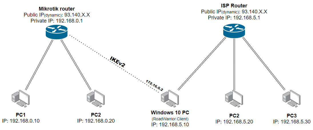

I configured IKEv2 on my Mikrotik to allow RoadWarrior clients access to my private network behind Mikrotik router which works perfectly. Clients can access all my network devices behind Mikrotik.
Now I have a situation where I need access to private network behind Windows 10 IKEv2 client. I can ping Windows 10 client with configured IKEv2 IP address(172.16.0.2), but private LAN behind Windows 10 client(192.168.5.0/24) is not reachable. I tried adding 192.168.5.0/24 network to route table with 172.16.0.2 gateway on my MK without success. I think there is a problem on Windows 10 PC that I’m not aware of it. IP Forwarding is enabled on Windows 10 PC. Do I need to setup anything for IP Forwarding to work or add a static route on Windows client?
Any help appreciated.
To be clear are you saying you would like to from your PC behind the Mikrotick, reach a road warrior computer??
Draw a diagram its confusing!!!
I would like to reach a road warrior private network(192.168.5.0/24) over IKEv2(172.16.0.2) from Mikrotik router.
Then I suspect you need an MK connection to the road warrior router…
I dont think this is an MT issue but perhaps how to configure something on a windows 10PC, perhaps with dual nic cards??
Just guessing, as I dont think what is requested is possible but limited knowledge in this area..
