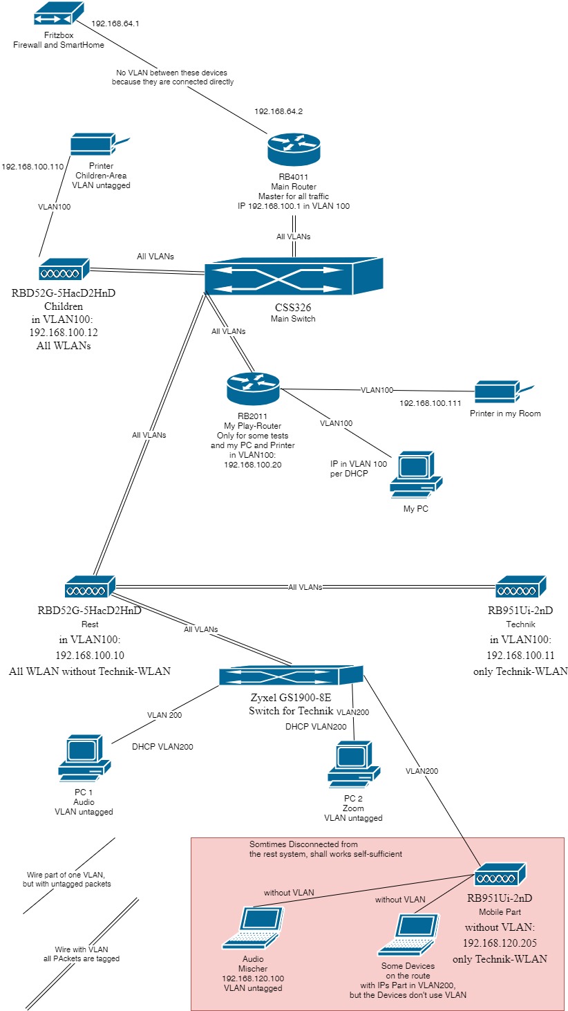

Access to Router in LAN2
I have two (in fact 5) VLAN, and in both there are Mikrotiks and other devices, some of them I like to see in the other VLAN.
VLAN100: vlan100_Mitarbeiter, Network: 192.168.96.0/20 - There is my PC and the most Mikrotiks, like this one, I call it MainRouter here.
VLAN200: vlan200_Technik, Network: 192.168.112.0/20 - There are two devices I like to access from my PC: a “Mischpult” and another Mikrotik, I call it “AP-Router” here.
The device “Mischpult” in VLAN200 with IP 192.168.120.100 is accessable from the VLAN100 via IP 192.168.100.200
I thought I could made this for “AP-Router” in VLAN200 with IP 192.168.120.205 via IP 192.168.100.14 in VLAN100.
Why does the device “Mischpult” works, the device “AP-Router” not?!? You see me after hours of tries… now only remote connected, the afternoon direcly sitting in VLAN100…
First, a ping from the Mikrotik MainRouter, which does the masquerading, works: ping to 192.168.120.205 is ok, the connection is up and running.
If I change my PC to VLAN200, I can access the “AP-Router”. But why am I not able to masquerade like the “Mischpult”?!?

    name-prefix=cap2G slave-configurations="Technik_2G,Gast 2G"
add action=create-dynamic-enabled disabled=yes hw-supported-modes=gn \
    master-configuration="Mitarbeiter 2G" name-format=prefix-identity \
add bridge=bridge_LAN frame-types=admit-only-vlan-tagged ingress-filtering=\
    yes interface="E10_AP Gr Saal" pvid=100
    yes interface=E0-sfp_Uplink
    yes interface=bond_Room1 pvid=100
add bridge=bridge_LAN interface=bond_Room3
add bridge=bridge_LAN interface=bond_Switch
    yes interface=bond_Kinder
/interface bridge settings
set allow-fast-path=no use-ip-firewall=yes
/ip settings
/interface bridge vlan
add bridge=bridge_LAN tagged="bridge_LAN,bond_Room3,bond_Switch,bond_Kinder\
    ,bond_Room1,E0-sfp_Uplink,E10_AP Gr Saal" vlan-ids=100
add bridge=bridge_LAN tagged="bridge_LAN,E10_AP Gr Saal,bond_Room1,bond_Pastora\
    t,bond_Switch,bond_Kinder,E0-sfp_Uplink" vlan-ids=200
    t,bond_Switch,bond_Kinder,E0-sfp_Uplink" vlan-ids=500
add bridge=bridge_LAN tagged=\
    bridge_LAN,bond_Room3,bond_Switch,E0-sfp_Uplink vlan-ids=800
    bridge_LAN,bond_Switch,bond_Room3,E0-sfp_Uplink vlan-ids=900
add interface=E1_Internet list=WAN
/interface ovpn-server server
set auth=sha1 certificate=efggoslar_Server.crt_0 cipher=aes256 \
    default-profile=RoadWarrior enabled=yes mode=ethernet netmask=20 \
    require-client-certificate=yes
/interface wireless cap
set bridge=bridge_LAN certificate=request discovery-interfaces=\
    vlan200_Technik enabled=yes interfaces=wlan2G,wlan5G
add address=192.168.100.1/20 comment="Router im Hauptnetz: Router selber" \
    interface=vlan100_Mitarbeiter network=192.168.96.0
add address=192.168.120.1/20 comment=Technik interface=\
    vlan200_Technik network=192.168.112.0
add address=192.168.150.1/19 comment="Gastnetz Offen" interface=vlan500_Gast \
    network=192.168.128.0
add address=192.168.180.1/21 comment="Kleine WG" interface=vlan800_KlWg \
    network=192.168.176.0
add address=192.168.190.1/23 comment="Gro\DFe WG" interface=vlan900_GrWg \
    network=192.168.190.0
add address=192.168.100.2/20 comment="Router im Hauptnetz: FritzBox-MASQ" \
add address=192.168.64.2/24 comment="Router im Fritznetz" interface=\
    E1_Internet network=192.168.64.0
add address=192.168.100.14/20 comment="Router im Hauptnetz: Router Mischpult" \
add address=192.168.120.110/20 interface=vlan200_Technik \
add address=192.168.120.111/20 interface=vlan200_Technik \
add address=192.168.120.200/20 interface=vlan200_Technik \
add address=192.168.100.200/20 comment="Router im Hauptnetz: Mischpult" \
/ip dhcp-server lease
add address=192.168.100.100 client-id=1:5c:f4:ab:e4:c0:8f comment=\
    "Server" mac-address=5C:F4:AB:E4:C0:8F server=dhcp100
add address=192.168.120.101 client-id=1:94:db:56:2a:ae:29 comment=\
    "Tec TV Kl. Saal" mac-address=94:DB:56:2A:AE:29 server=dhcp200
add address=192.168.120.102 client-id=1:94:db:56:9a:cf:c5 comment=\
    "Tec TV Kinder" mac-address=94:DB:56:9A:CF:C5 server=dhcp200
add address=192.168.100.110 client-id=1:ec:9a:74:35:d8:bf comment=\
    "Drucker" mac-address=EC:9A:74:35:D8:BF server=dhcp100
add address=192.168.100.111 client-id=1:0:1b:a9:54:bb:8f mac-address=\
    00:1B:A9:54:BB:8F server=dhcp100
add address=192.168.120.120 client-id=1:dc:a6:32:d8:2b:39 comment=\
    Videomischer mac-address=DC:A6:32:D8:2B:39 server=dhcp200
add address=192.168.120.150 client-id=1:bc:5f:f4:f8:d4:b1 comment="Video PC" \
    mac-address=BC:5F:F4:F8:D4:B1 server=dhcp200
add address=192.168.96.0/20 comment=Mitarbeiter dns-server=192.168.100.1 \
    gateway=192.168.100.1
add address=192.168.112.0/20 comment=Technik dns-server=\
    192.168.120.1 gateway=192.168.120.1
add address=192.168.128.0/19 comment=Gast dns-server=192.168.150.1 gateway=\
    192.168.150.1
add address=192.168.176.0/21 comment="Kleine WG" dns-server=\
    192.168.180.1 gateway=192.168.180.1
add address=192.168.190.0/23 comment="Gro\DFe WG" dns-server=\
    192.168.190.1 gateway=192.168.190.1
set allow-remote-requests=yes servers=192.168.100.2,192.168.64.1
add action=fasttrack-connection chain=forward comment="Grund: fasttrack" \
    connection-state=established,related disabled=yes
    "Grund: Acc Forw established,related, untracked" connection-state=\
    established,related,untracked
add action=accept chain=forward comment="Winbox ist ok" dst-address=\
    224.0.0.0/4 log-prefix=Multicast
add action=drop chain=forward comment="Grund: Drop Forw invalid" \
    connection-state=invalid
add action=accept chain=forward port=8291 protocol=tcp
add action=accept chain=forward comment="Nur eigene Netze im Netz" \
    dst-address=192.168.96.0/20 log=yes log-prefix=MA-Netz src-address=\
    192.168.96.0/20
add action=accept chain=forward dst-address=192.168.112.0/20 log-prefix=\
    Veranst.-Netz src-address=192.168.112.0/20
add action=accept chain=forward dst-address=192.168.176.0/21 log-prefix=\
    Kl.WG-Netz src-address=192.168.176.0/21
add action=accept chain=forward dst-address=192.168.190.0/23 log-prefix=\
    GrWG-Netz src-address=192.168.190.0/23
add action=accept chain=forward dst-address=192.168.120.1 log-prefix=\
    "Gastnetz nur zum Router erlaubt" src-address=192.168.128.0/19
add action=accept chain=forward comment="Eigene Netze ins Internet" \
    in-interface=vlan100_Mitarbeiter log-prefix=MA-Netz out-interface=\
    E1_Internet src-address=192.168.96.0/20
add action=accept chain=forward in-interface=vlan200_Technik \
    log-prefix=Gaeste out-interface=E1_Internet src-address=192.168.112.0/20
add action=accept chain=forward in-interface=vlan500_Gast log-prefix=Gaeste \
    out-interface=E1_Internet src-address=192.168.128.0/19
add action=accept chain=forward in-interface=vlan800_KlWg log-prefix=\
    KlWohnung out-interface=E1_Internet src-address=192.168.176.0/21
add action=accept chain=forward in-interface=vlan900_GrWg log-prefix=\
    GrWohnung out-interface=E1_Internet src-address=192.168.190.0/23
add action=accept chain=forward comment="Router d\FCrfen alles" log-prefix=\
    "Router in alles" src-address=192.168.100.0/24
add action=accept chain=input log-prefix="Technik auf Router" src-address=\
    192.168.112.0/20
add action=accept chain=output dst-address=192.168.112.0/20 log-prefix=\
    "Technik von Router"
    "Grund: Acc Input established,related,untracked" connection-state=\
add action=accept chain=input comment="Winbox Firewall" dst-port=8291 \
    protocol=tcp
add action=accept chain=output log-prefix=Winbox->DirksLT protocol=tcp \
    src-port=8291
add action=accept chain=input comment=OpenVPNZugang dst-port=1194 log-prefix=\
    "VPN In" protocol=tcp
add action=accept chain=output log-prefix="VPN Out" protocol=tcp src-port=\
    1194
add action=accept chain=forward comment="Mikrotik Discovery" log-prefix=\
    "Mikrotik Discovery erlauben" port=5678 protocol=udp src-address=\
    192.168.96.0/20
add action=accept chain=forward log-prefix="Mikrotik Discovery erlauben" \
    port=5678 protocol=udp src-address=192.168.112.0/20
add action=accept chain=forward dst-address=192.168.96.0/20 log-prefix=\
add action=accept chain=forward log-prefix="Mikrotik Diskover all" port=5678 \
    protocol=udp
# ovpn-DirksPC not ready
add action=accept chain=forward comment="OVPN darf alles" in-interface=\
    ovpn-DirksPC log-prefix="OVPN Darf alles" src-address=192.168.201.0/24
add action=accept chain=forward in-interface=ovpn-DirksLT log-prefix=\
# ovpn-Ralf not ready
add action=accept chain=forward in-interface=ovpn-Ralf log-prefix=\
# ovpn-Florian not ready
add action=accept chain=forward in-interface=ovpn-Florian log-prefix=\
    "OVPN Darf alles" src-address=192.168.202.0/24
add action=accept chain=forward comment="Ins OVPN_Netz erlauben" dst-address=\
    192.168.201.0/24 log-prefix="Ins OVPN-Netz"
    192.168.202.0/24 log-prefix="Ins OVPN-Netz"
add action=drop chain=input comment="Grund: Drop Input invalid" \
add action=accept chain=input comment="Grund: Acc ICMP" protocol=icmp
add action=accept chain=input comment="Grund: Acc loopback (z.B. CAPsMAN)" \
    dst-address=127.0.0.1
add action=drop chain=input comment="Grund: Drop alles nicht im LAN" \
    disabled=yes in-interface-list=!LAN
add action=accept chain=forward comment="Grund: Acc ipsec-in" ipsec-policy=\
    in,ipsec
add action=accept chain=forward comment="Grund: Acc ipsec-out" ipsec-policy=\
    out,ipsec
add action=accept chain=forward connection-nat-state=srcnat,dstnat log=yes \
    log-prefix="NAT erlauben"
    "Grund: Drop WAN von aussen ohne Anfrage innen" connection-nat-state=\
    !dstnat connection-state=new in-interface=E1_Internet
    "Alles was nicht erlaubt ist ist verboten" log=yes log-prefix=\
    "Nicht erlaubt"
/ip firewall mangle
add action=log chain=prerouting log-prefix="Test Backroute" protocol=icmp \
    src-address=192.168.120.205
add action=log chain=postrouting log=yes log-prefix="Test Backroute" \
    protocol=icmp src-address=192.168.120.205
add action=log chain=prerouting dst-address=192.168.100.14 log=yes \
    log-prefix="Test OldIP" protocol=icmp
add action=log chain=postrouting dst-address=192.168.100.14 log=yes \
    log-prefix="Test OrgIP" protocol=icmp
add action=log chain=postrouting dst-address=192.168.120.205 log=yes \
    log-prefix="Test DestIP" protocol=icmp
add action=mark-packet chain=prerouting disabled=yes dst-address=\
    192.168.112.0/20 log-prefix=Test new-packet-mark=Technik \
    passthrough=yes
add action=mark-packet chain=prerouting disabled=yes new-packet-mark=\
    Technik passthrough=yes src-address=192.168.112.0/20
    192.168.128.0/20 new-packet-mark=Gaeste passthrough=yes
add action=mark-packet chain=prerouting disabled=yes new-packet-mark=Gaeste \
    passthrough=yes src-address=192.168.128.0/20
add action=dst-nat chain=dstnat comment="Router Mischpult" dst-address=\
    192.168.100.14 log=yes log-prefix=DestNat to-addresses=192.168.120.205
add action=src-nat chain=srcnat comment="Router Mischpult" dst-address=\
    192.168.120.205 dst-port=8291 log=yes log-prefix=MasqWinbox protocol=tcp \
    src-address=192.168.200.0/24 to-addresses=192.168.120.1
    src-address=192.168.96.0/20 to-addresses=192.168.120.1
add action=src-nat chain=srcnat comment="Router Mischpult" out-interface=\
    ovpn-DirksLT src-address=192.168.120.205 to-addresses=192.168.201.1
add action=masquerade chain=srcnat comment="Masq nach aussen" ipsec-policy=\
    out,none log-prefix=Internet out-interface=E1_Internet
add action=dst-nat chain=dstnat comment=Fritz-Box dst-address=192.168.100.2 \
    log-prefix=Fritz-Box to-addresses=192.168.64.1
add action=dst-nat chain=dstnat comment="Mischer im Hauptnetz" dst-address=\
    192.168.100.200 to-addresses=192.168.120.100
add action=dst-nat chain=dstnat comment=BeamPC dst-address=192.168.100.201 \
    to-addresses=192.168.120.150
add action=dst-nat chain=dstnat comment=\
    "Geraete ins Techniknetz: NAS, Drucker" dst-address=192.168.120.200 \
    to-addresses=192.168.100.100
add action=dst-nat chain=dstnat dst-address=192.168.120.110 to-addresses=\
    192.168.100.110
add action=dst-nat chain=dstnat dst-address=192.168.120.111 to-addresses=\
    192.168.100.111
add action=src-nat chain=srcnat comment="Road Warrior" src-address=\
    192.168.201.0/24 to-addresses=192.168.100.3
add action=src-nat chain=srcnat comment="Road Warrior Technik" src-address=\
    192.168.202.0/24 to-addresses=192.168.200.3
add distance=1 gateway=192.168.64.1
add distance=1 dst-address=10.10.1.0/24 gateway=192.168.100.21
add distance=1 dst-address=192.168.1.0/24 gateway=192.168.100.20
add distance=1 dst-address=192.168.88.0/24 gateway=192.168.100.20
/ppp secret
add name=DirkLT profile=RoadWarrior
add name=Florian profile=RoadWarriorTechnik service=ovpn
add name=DirkPC profile=RoadWarrior
add name=Ralf profile=RoadWarrior
add name=David profile=RoadWarriorTechnik service=ovpn
add name=Benjamin profile=RoadWarriorTechnik service=ovpn
/radius
add address=192.168.100.1 service=hotspot,wireless
/radius incoming
set accept=yes
/routing pim bsr-candidates
add disabled=yes interface=vlan200_Technik
/routing pim interface
add alternative-subnets=192.168.112.0/20,192.168.96.0/20,192.168.128.0/19 \

Can you provide a drawing of how all this is hooked up?
Here is my plan, I hope you can see what you wanted - I never learned drawing network-plans…
The point is, I want to see the devices, mainly the Routerboard from my PC when they are connected to the rest of the network.
AND I think, I have one point not understood from masquerading so this behavior happends.
Please tell me that all the various routers EXCEPT the RB4011 are only being used as managed switches and not routers.
Unless I am badly missing something, if you are doing ANY routing function in the rest of the routers, you are only making your life more complex.
And I can’t help you much on the configuration of routers being used only as a managed switch - as I don’t do that anywhere. Routers are used as routers and switches are used as switches.
Of course, they are only used as managed switches, no routing on them.
Most of them as WLAN-APs, managed by CAPsMAN in RB4011, and dividing the VLANs for the ports. Mostly just one route:

And because the RB2011 was not in use, I put it to my place so I can use his display to see what happenings on his ports. Sometimes I change the port my PC uses so I can put him into different VLANs.
But I wonder:
I can Ping the Mobile-Part-Router with IP 192.168.120.205 from RB4011, and I can connect him from my PC if I plug my PC in VLAN200 (RB2011 as managed Switch, just a Port who sends Packets from VLAN200 without VLAN-Tag, and gives incoming Packets the VLAN-Tag of VLAN200).
And I can get a connection to “Mischer” with IP192.168.120.100 via Dst-Nat
