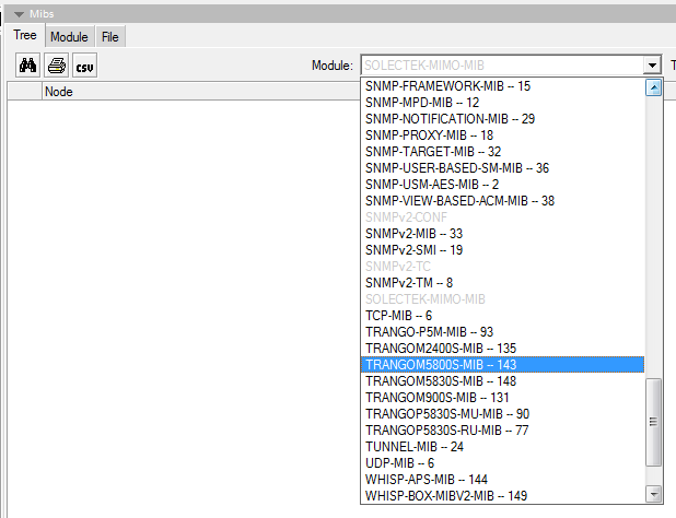

Add MIB and it is greyed out?
I have not bothered to add custom MIBs in the past, for I have not needed them. Today, I added one from the manufacturer. The problem is, it is greyed out in the interface and does not seem to be used.
What am I missing?
Please see the following image:
1539901 v20 SkyWay-EXCEL.zip (3.47 KB)
Only guess would be there is another dependent mib missing. I have not installed the soletek mib.

I stil cannot get their MIB to work, but your function gets the most important info for monitoring. THANKS.
