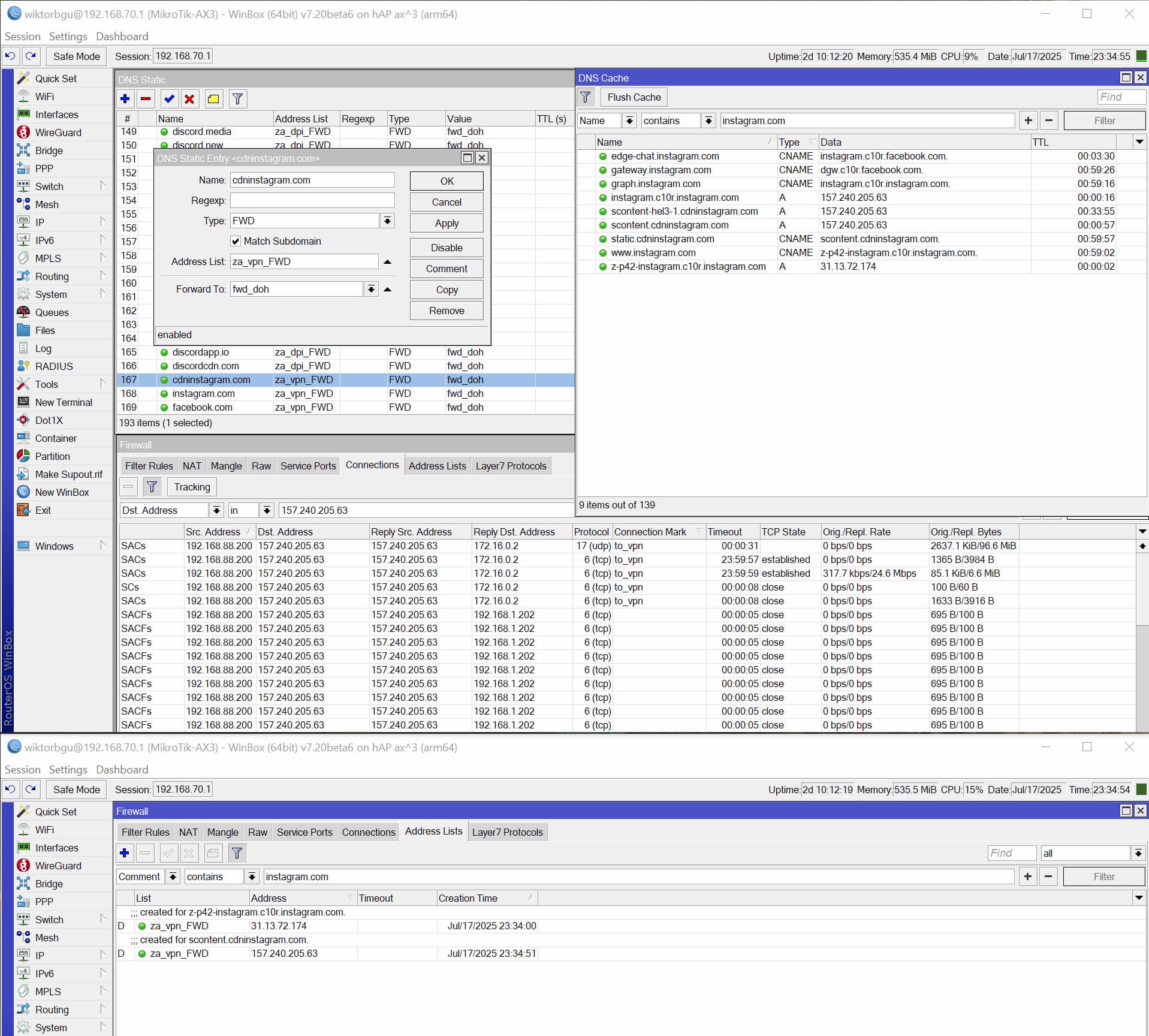

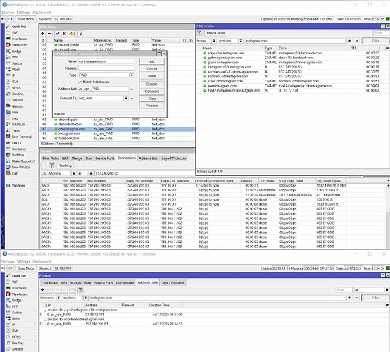

My config DNS FWD:
/ip dns static add address-list=za_vpn_FWD forward-to=fwd_doh match-subdomain=yes name=cdninstagram.com type=FWD
/ip dns static add address-list=za_vpn_FWD forward-to=fwd_doh match-subdomain=yes name=instagram.com type=FWD
The resolved list of addresses is wrapped in a tunnel by Mangle. In the case when different DNS names receive the same IP addresses, after the shortest TTL expires, the address is removed from the list and despite the fact that other records with the same address live in the DNS cache, sending these addresses to the tunnel breaks, because it is no longer in the list.
This is a side case, as the problem is also reproducible with clean cache, so I believe there’re two bugs probably. Would be nice if someone from MikroTik could give a summary about the feature state and if they can/want reproduce the problem. FWD+mangle is huge QoL
