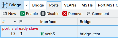

As soon as I issue these commands (the order isn't relevant, it happens whenever all three conditions are met: 1. veth5 is in a VRF; 2. veth5 is in a bridge; 3. veth5 is assigned to a running container), the error "port is already a slave" is shown in the bridge ports list:
veth5 is not part of any other bridge, and as soon as the container is stopped, the error vanishes. I wasn't able to find any documentation regarding the combination of containers and VRFs, but I guess this is a bug, and if the combo is supposed to be unsupported, it would be great to have an error message along the lines of "containers are not supported inside VRFs"
Your config is incorrect. If veth5 is a part of the bridge, only the bridge should be an interface of the vrf.
If you correct this, do you still get the error?
Wow, thanks! Indeed, removing veth5 from the VRF solves the issue and the bridge works as expected. I expected to have to put all the interfaces belonging to the VRF into its config, so didn't even consider not adding veth5 a viable option!
You may still wish to write a support request, because the error message is less than clear... Maybe it could be improved.
