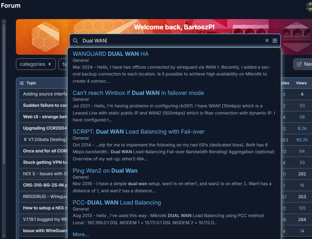

Search the Forum for Dual WAN topics and read them. You will find a lot of usefull info.
Thanks. Got it. I have never used recursive routing, which is so easy. There are still issues with dynamic IP providers (like Starlink), but I can work through these.
