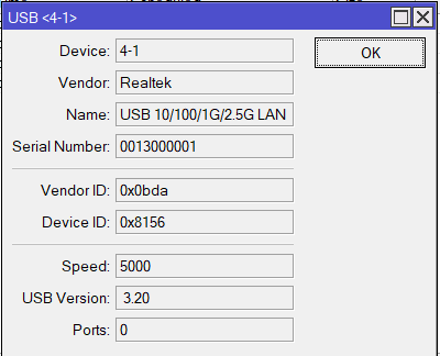

I tried this one. No ethernet created.
I don’t believe routeros will allow you to add usb/ether adaptors.

I have few 1Gbps Realteks which are simply working and new ethernet interface is added. All what should be needed is to add 2.5Gbps Realtek FW to .npk. If there is recent enough kernel used by mikrotik indeed.
7.16 recently added support for RTL8156, but for now only for x86.

I have an RB5009. I had the same issue where I could not find a supported USB Ethernet adapter, usually either not turning up in the interface list, or not able to negotiate a link. It was solved easily, as I found “extra-nic-7.19.1-arm64.npk” extra drivers in the all packages directory of latest RouterOS. All ok and tested well. Usually this is for x86 hardware needing additional NIC support. However, it also worked on RB5001 (arm64). In this case a AX88179 USB Ethernet chip. Likely work for many more.
