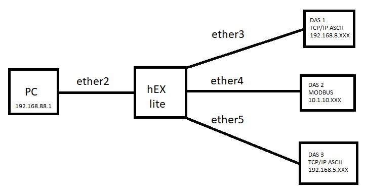

I have three different types of field data acquisition systems (DAS), and each type has an IP address in a specific range and I want to be able to communicate with all of them from a laptop with a single ethernet port.
So, on a given job I might have three data acquisition systems streaming simultaneously, but only one of each type - never multiples.
DAS 1 : 192.168.8.10
DAS 2 : 10.1.10.15
DAS 3 : 192.168.5.103

Likewise, no luck. I haven’t been able to successfully ‘ping’ any of the data source devices on ether3, 4, or 5.
Am I on the right track here thinking this needs to be set up as a VLAN? Or am I barking up the wrong tree. Really just looking for someone to point me in the right direction here.
Thanks in advance!
