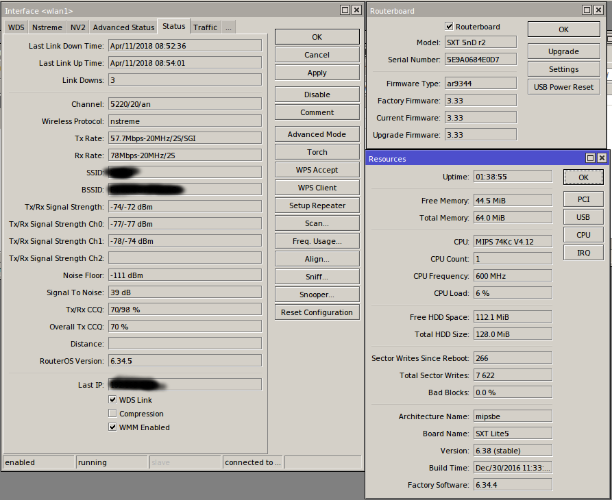

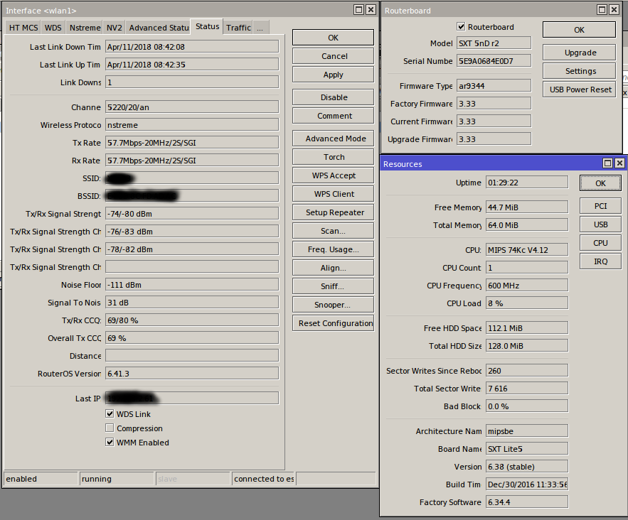

How much lower?
before the update
after the update

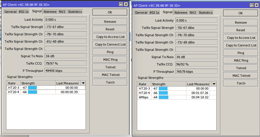

Wow - there is a big difference in signal levels between those versions ?

Here is 6.40.4 so long…
Yes

OK results as follows:
SXT 6.41 + Sector 6.40.6
SXT 6.34.6 + Sector 6.36.4 (came out with 6.35 so didn’t want to downgrade too far and potentially break anything)
My settings:
Sector:
/interface wireless
set [ find default-name=wlan1 ] country=“south africa” default-forwarding=no
disabled=no frequency=5825 frequency-mode=superchannel mode=ap-bridge
radio-name=“xxx” ssid=zzz wireless-protocol=nv2
wps-mode=disabled
SXT:
/interface wireless
set [ find default-name=wlan1 ] adaptive-noise-immunity=client-mode band=
5ghz-a/n country=“south africa” disabled=no proprietary-extensions=
pre-2.9.25 radio-name=“xxx” ssid=zzz
Excuse the bad CCQ, still trying to find good frequency…
