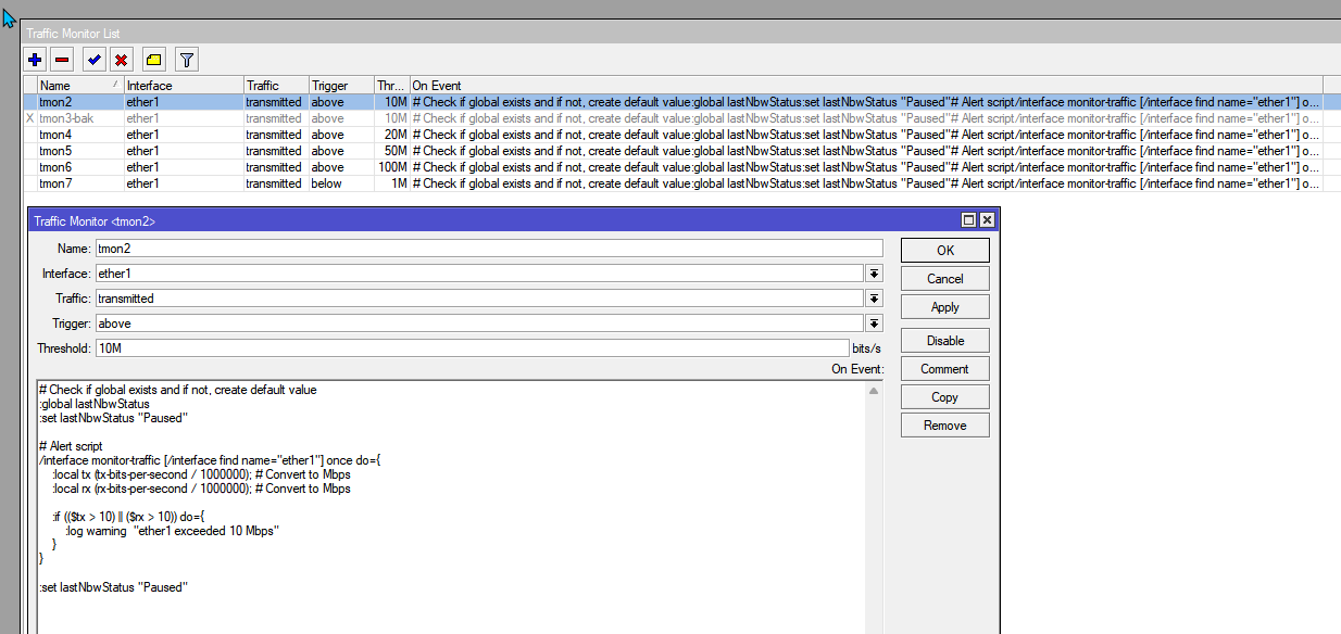

i added 4 thresholds about 2M just to test. for In ether1 High Script i added above 2M threshold and for In ether1 Normalized i added below 2M threshold for traffic received, and for traffic transmitted i added Out ether1 Normalized and Out ether1-GW1 High Script I got 2 emails that one is that Inbound Traffic Too High and Inbound Traffic Normalized at the same time

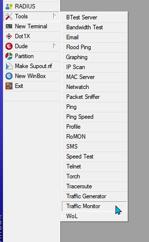

Hello tomislav91
What do you mean by “created your own Traffic Monitor items for inbound / outbound, high / normal)”? What did you label/name the traffic monitor items in your example? Can you at least provide an example with screenshots? Thanks a lot. Regards, M
Thats it?

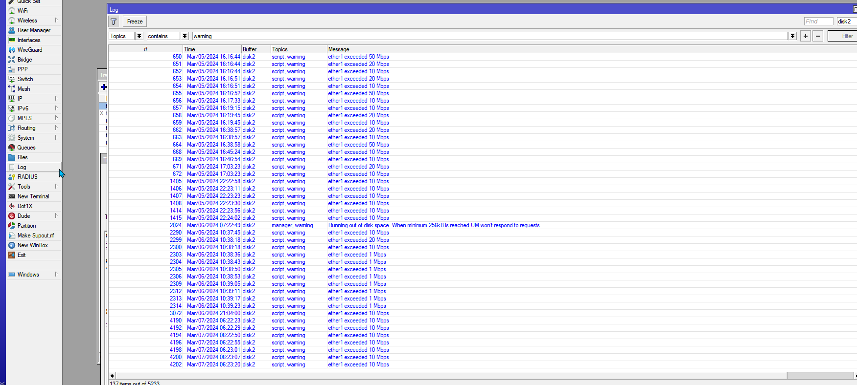

post from @tomislav91 helped me tune my version of script.
Check if global exists and if not, create default value
:global lastNbwStatus
:set lastNbwStatus "Paused"
Alert script
/interface monitor-traffic [/interface find name="ether1"] once do={
:local tx (tx-bits-per-second / 1000000); # Convert to Mbps
:local rx (rx-bits-per-second / 1000000); # Convert to Mbps
:if (($tx > 10) || ($rx > 10)) do={
:log warning "ether1 exceeded 10 Mbps"
