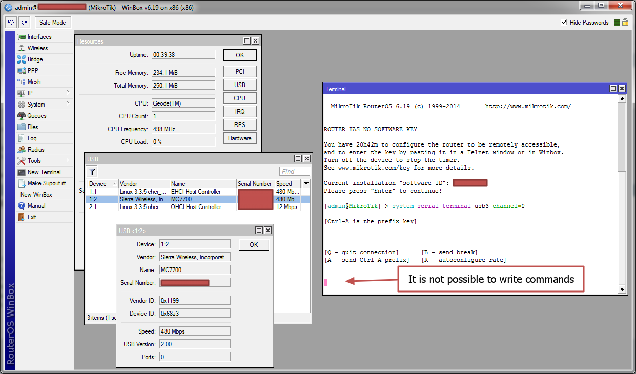

I am working with RouterOS and Alix6f2…
http://www.pcengines.ch/alix6f2.htm
but not working modem MC7700. I’ve upgraded the modem firmware to the latest version available (3.5.20.5).

The MC7700 if it is recognized but only you can see an available port (port 0). This port does not allow me to run any command AT.
Check if you have LTE interface. If yes it means that MC7710 is working in DirectIP mode (to get full LTE speed). Set APN at LTE interface and add DHCP client for it.
If you want access it via serial you can disable DirectIp (/port firmware set ignore-directip-modem=yes), but then you have to use much slower PPP mode.
That worked, thanks…
