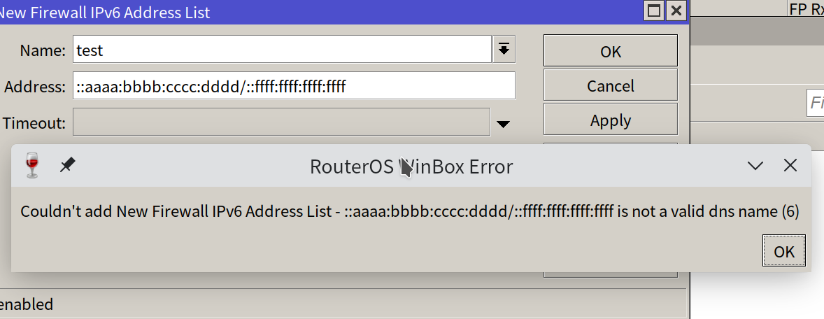

Allowing IPV6 traffic to device with dynamic IPV6 prefix behind firewall
IP6TABLES https://linux.die.net/man/8/ip6tables allows specifying a mask when matching destination address
so we can use
/ffff:ffff:ffff:ffff:0000:0000:0000:0000
(equeal to /ffff:ffff:ffff:ffff::)
as the mask to represent
/64
The pointer is,when I want to match the last 64 bit part ,I can use mask
/0000:0000:0000:0000:ffff:ffff:ffff:ffff:
(equeal to /::ffff:ffff:ffff:ffff)
This is very useful when I have a dynamic IPV6 prefix and want my routeros to allow some device behind firewall to be visited by outside
I can do this easily with IP6TABLES
ip6tables -I FORWARD -d ::aaaa:bbbb:cccc:dddd/::ffff:ffff:ffff:ffff -p tcp --dport 22 -j ACCEPT
I can’t do it with routeros

Routeros

Routeros is still have no solution on firewall dsy.address under Dynamic DHCPv6 prefix delegation senario, I’m still waiting for it …
By the way, I can open some ports for my server thoug… BUT… That’s for ALL my inner network devices, which isn’t a good practice. and I have noticed that The ipv6 firewall has a rule called “Src.mac”, So why we don’t have an option called “Dst.mac” ? I’m sure we can know the “destination ipv6 address” stands for which NIC as we have some thing called “ipv6 neighbor discovery”.
Edited topic title to as it SHOUTED.
