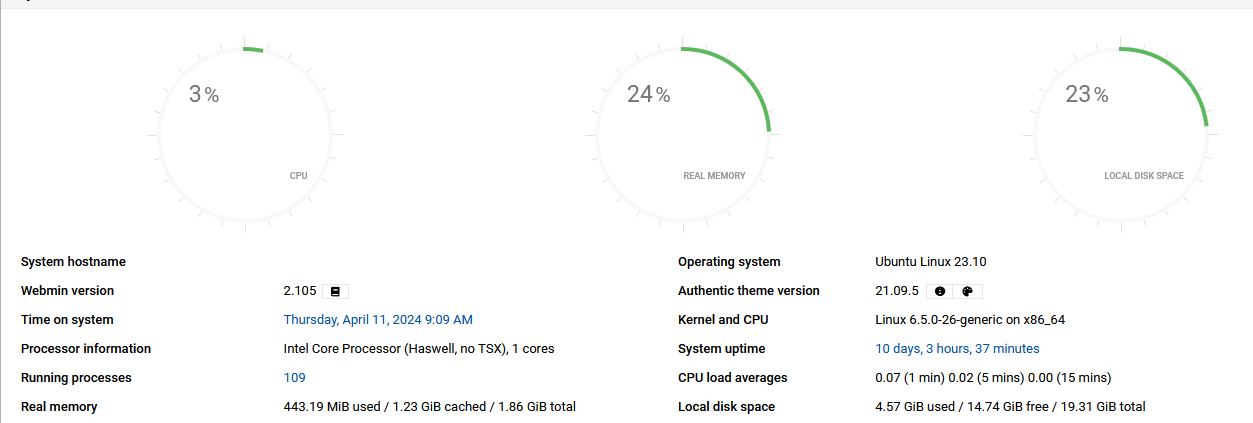

Also it says 2GB of RAM is needed for the server
Looks like it has everything needed. So all you need is a powerful ARM device with enough RAM
My server with 2 dockers (as far as i know new docker is created for every protocol and i have AWG and OpenVPN over Cloak installed) uses 500 Mb
