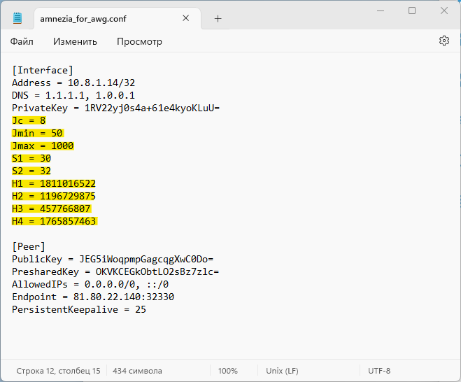

+1 in fact, these are just a couple of additional settings in WireGuard settings that will make life easier for many people who are under DPI blocks.
All you need to do is add the ability to change the values of these fields. By default, they are standard, but the essence of amnesia is that by redefining the standard values of these parameters, you can bypass the blocking of the wireguard protocol
Do both ends of the connection require the same set of altered values in the highlighted fields?
