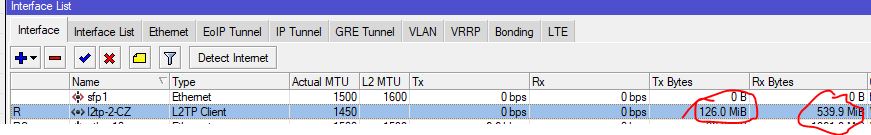

analysis traffcic by interface
who is it possible to send ma an email, every x time from an interface with rx and tx bytes ?
Regards Daniel
