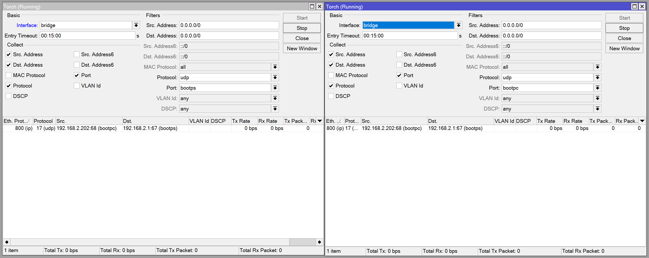

You may also try Torch (Tools → Torch) to see whether TV tries to renew its lease:
@Amm0 tryed with netmask 24 and removing the device id. Not getting IP when lease is expiring. Other tip?
