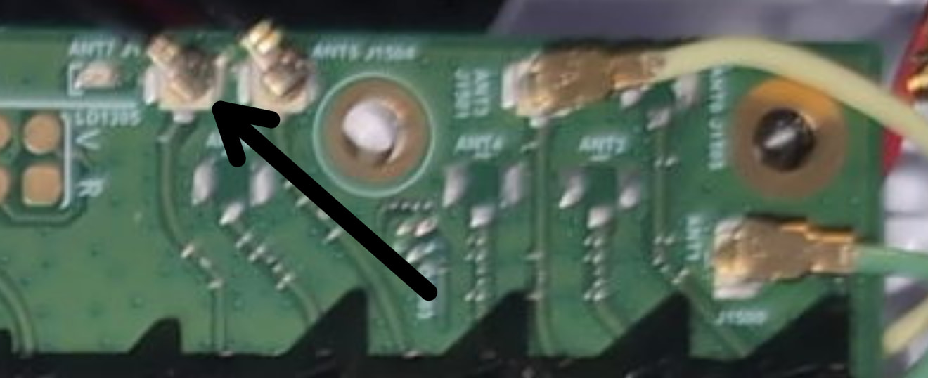

hello everyone I would need help, I would need to increase the capacity d, my router MikroTik Chateau 5G R17 ax, someone managed to install an external antenna, can you help me understand how to do it? Thank you for your help

Hi and thanks, I'm not very practical with electronics, I'll get help from a technician. In the photo I can't figure out how to understand the antenna number ant1 What is it, ant7 What is it. Can you help me figure out which cables to use for the external antenna. Thank you for the help
@patrikg On the external post:
In the picture I just put it on
ANT7 (was green, right internal antenna) and
ANT5 (was red, upper right internal antenna)
so, probably is "yes", the next is ant5
