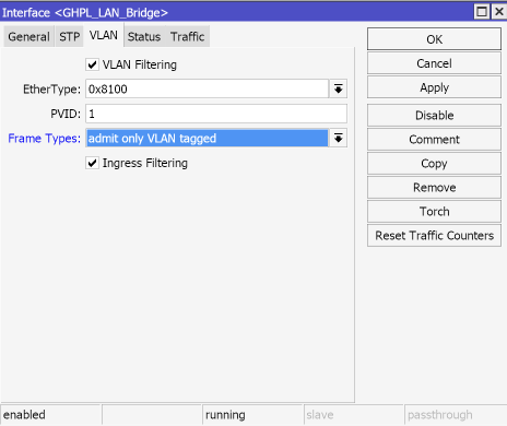

I am using CRS326 as my switch while using vlan filtering and it works okay. However by an accident, I had misconfigured the bridge VLAN settings by selecting the “admit only VLAN tagged” in the Frame Types selector. After that, I cannot connect the switch via Winbox.
Can anyone help me out to reconnect to the switch? Thanks very much in advance.

The bridge interface is connected to the switch ASIC via untagged traffic over the internal trunk link. You blocked that by changing frame type to “admit only VLAN tagged”.
