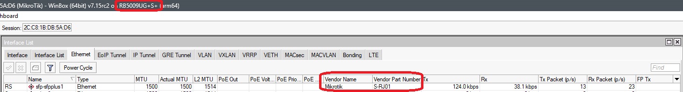

my first try was a S-RJ01 copper with no prpblems:

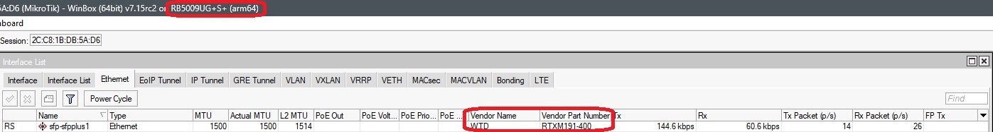

The second try was a HP J4859C fiber, also without any problems:

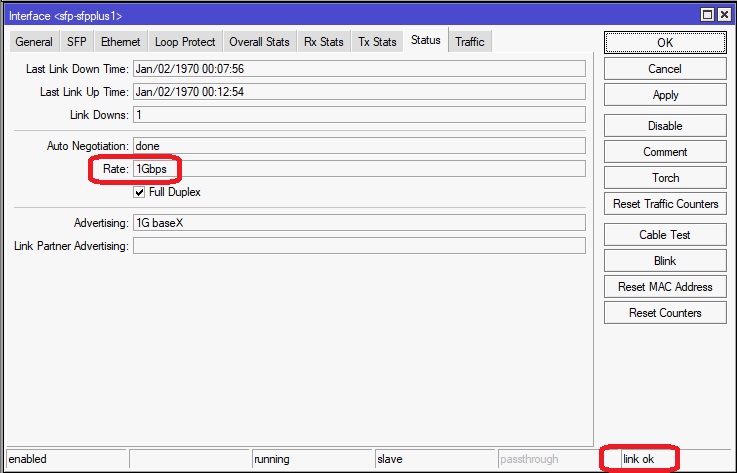

I have a pair of Mikrotik SFP s-5335LC20D, and 100 meters of single mode fiber between rb5009 and rb960.
Disabled auto-negotiation and set 1g port Speed.
On rb960 says link on
On rb5009 says link on, no link, link on, no link and within 5 minutes I can see more than 50 times link down, and when I tried to ping between this link, I can’t ping it… 100% loss
