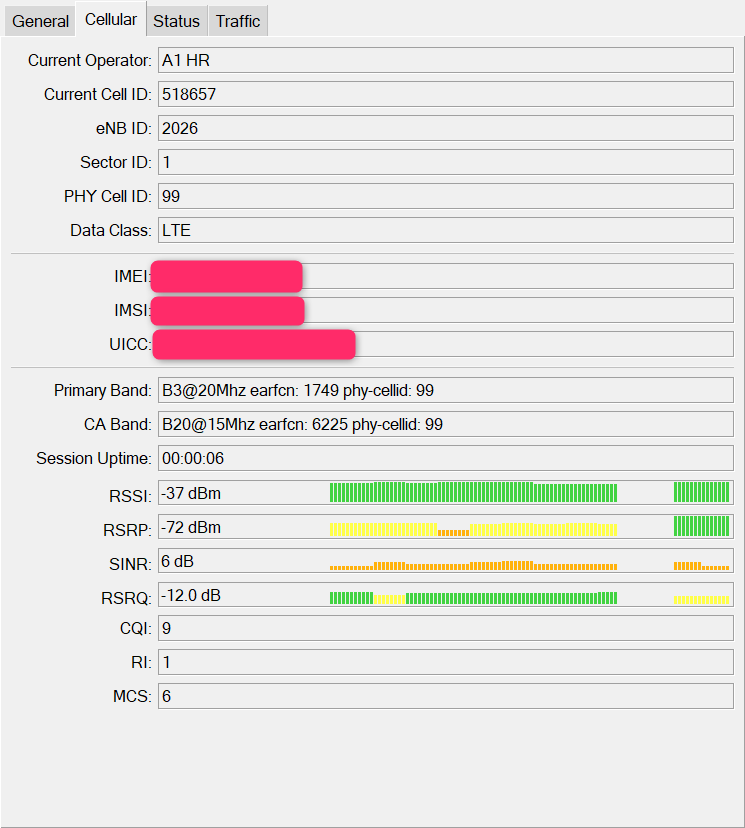

i just got my new LGH CAT18 antenna and i’ve tested it immediatelly.
So, not so happy :frowning:
this is with no bands chosen - default settings and i am getting like 25-30/60 DL/UL mbps

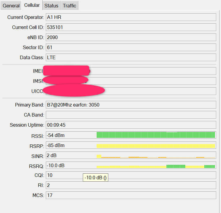

This is if i have chosen only band 7.. i am getting like 65/60 mbps DL/UL…
i did not aligned the antenna yet… in a sense.. i did not try to find the best or better base station location but plan to do it in the near future.

Can you combine B3+B7?

and looks like you have very strong signal, but signal quality is so so.. SINR looks very bad.. do you have direct vision to the tower available?
in my country CA works only when you start utilizing connection.. so run speedtest, and you should see CA bands too.
B20 is useless, switch it off..
You can cell lock your primary band to B7, and then CA with B3. CA is always set by provider.

Yes i can but i get much lower speeds.. especially in DL…
Yes.. i have direct visibility to the tower..
ok.. tx.. i’ll try to ‘play’ with locking the B7
yes… true… so… i can not use 4 x 4 with this antenna…
